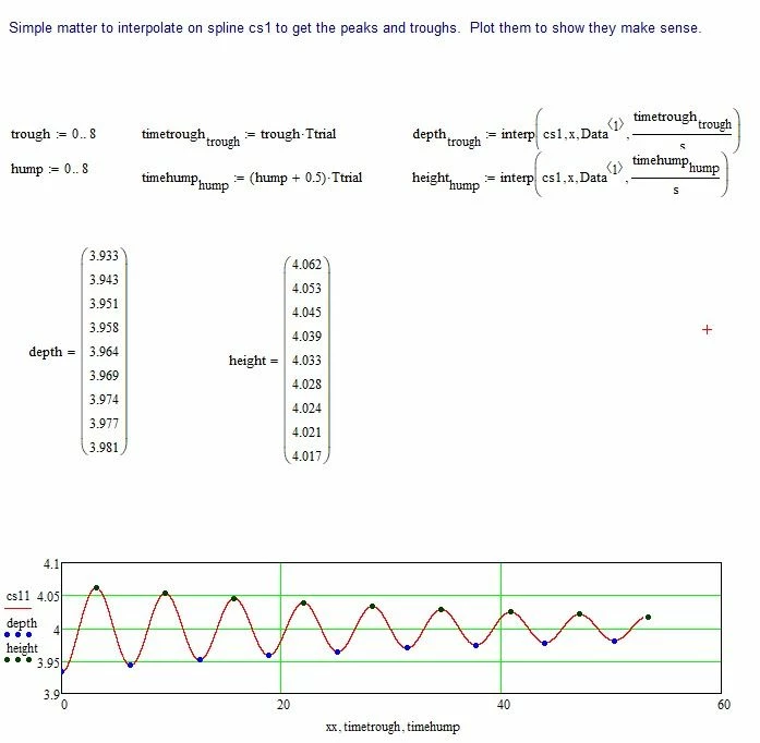

Said I was working on the amplitude of the oscillations and have an answer.
you can now use genfit() to fit the equation of the curve with these data points.
Cheers

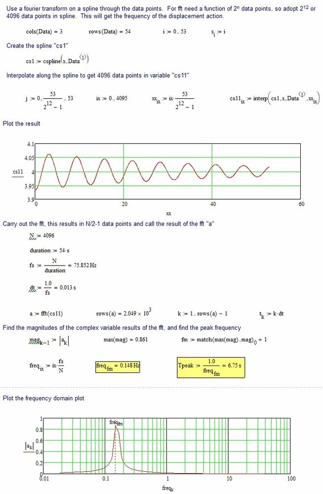

Hi
I have used the fft() function in Mathcad to obtain the peak period and frequency of the oscillations.  You can get the maximum and minimum displacement from the "cs1" spline easily with max(cs1) and min(cs1) functions.  Greater accuracy can be gained by using more points but for fft() they must be multiples of 2n.
I know this does not get the displacements of the lesser peaks but am working on this.

Wow, I did not thought and did not even know that Fourier transform can be applied in my situation! I will try your method in couple of hours to check how it behaves with second data set.
But as you mentioned, for my task I need to get each peak (at least only the reasonable ones)
And as I said it original post, the first data set is fine, all my calculations gave expected result, but the second one...
On that part, where magnitude gets smoller and smoller, starting with 5th peak (between 12s and 13s), trimmer func became an one-eye blind man and missed half of the nodes.
Anyway, really appreciate your effort. In case you get some progress (or not), would be glad if you tell about it

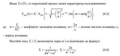

Well, I can neither approve, nor deny that. You see, for this laboratory work (I am a student) I had to do several calculations in order to get the data using special program with preset parameters, that simulates this oscillations. But because I study on-line at the moment, and as we dont have an access to this program, we were provided with already measured data. That formula, if we trust the manual to this task, is exactly the one that was used for that data, but I cannot even check if this is true. Picture attached (sorry for cyrillic, its in ukrainian)picture.png

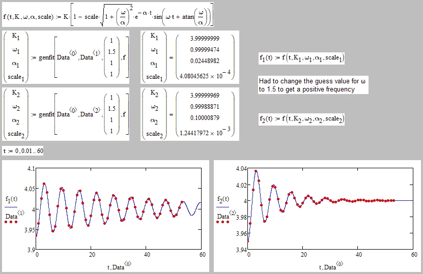

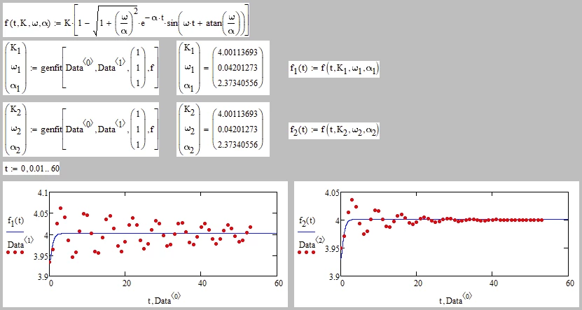

Oct 31, 2025 3:06 PM UTC
I was asking because I tried to determine the parameters of this function given the measured data.
But I had no luck as you can see below. The limit 4 (factor K) was calculated pretty nice, but frequency omega and alpha could not be determined to make a nice fit.
I combined K and Xin into a single factor K. Of course, I also tried different guess values -but without success.
I also played around changing the values for K, alpha and omega manually but could not find a suitable fit - the amplitudes came out much to high.
But once I added a scaling factor for the amplitude a nice fit could be achieved.
So that was the reason why I doubted that the measurement data originated from a process that could be modeled using the equation provided.  But maybe Xin is not a constant as I assumed but rather a function dependent on t -> Xin(t) ?
Nonetheless I am attaching my worksheet for whatever it may be worth.

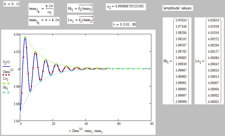

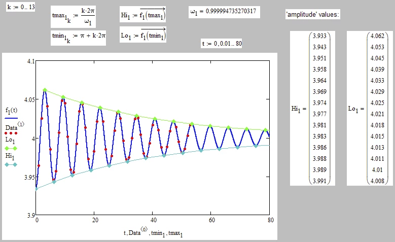

Oct 31, 2025 5:21 PM UTC
Given that the derivatives of both Xout functions (the original one and mine with the added scale factor) are basically just multiples of sin(omega*t) the maxima are at multiples of 2 pi /omega and the minima at pi + multiple +f 2 pi /omega.
So once the frequency omega is found calculating the extrema should be quite easy.
Given that my modified function gets pretty good fits we can use the omegas from there - actually both are very near to 1 which is possibly the value used when creating the data (as well as K=4 and not K=3.999999...)
EDIT: Also Terry found by other means a value (Ttrial=6.282 s) which correspond perfectly to 2 pi /omega with omega=1.
Here for the data column #2:
MC15 file attached
