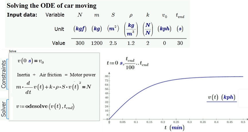

It will be good to use units by ODE solving.
See one example:
