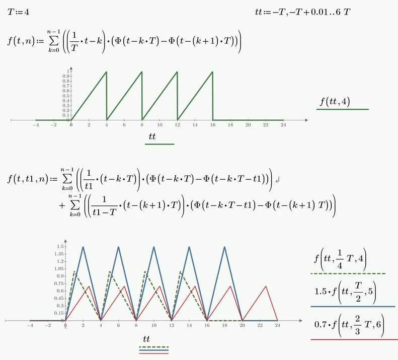

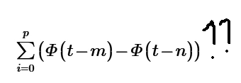

Pulse function using Heaviside Step Function
How can I make this pulse like function in more compact way but still following this variant from below?

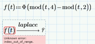

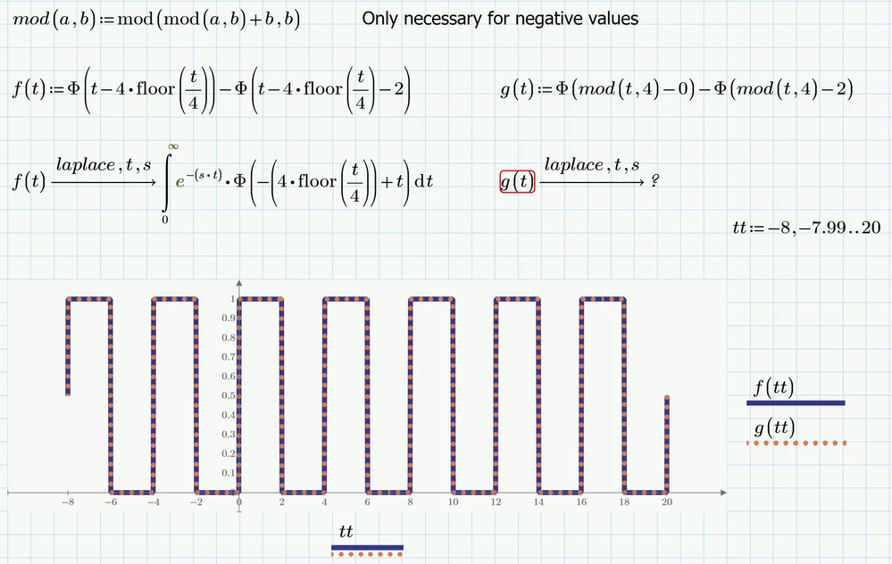

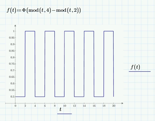

Looks like "laplace" can't deal with "mod", floor" and similar functions and so it can't give you a result for the piecewise and periodic function.
"laplace" can deal with a finite number of pulses, but even then it can't deal with the number of pulses being a variable and not a constant.
I guess that unless PTC implements some kind of rect(t) or SquareWave(t) function and tells the symbolics its laplace transform, we can't talk Prime into returning the result
which you may expect for your square wave.
-> LaplaceTransform (1/2*SquareWave(t/4)+1/2) - Wolfram|Alpha
-> [Solved] The Laplace transform of the causal periodic square wave of
-> integration - Laplace transform of a square wave function - Mathematics Stack Exchange

Hm, its a good variant also your variant. Idea is with the above variant we can do:
1. Laplace:

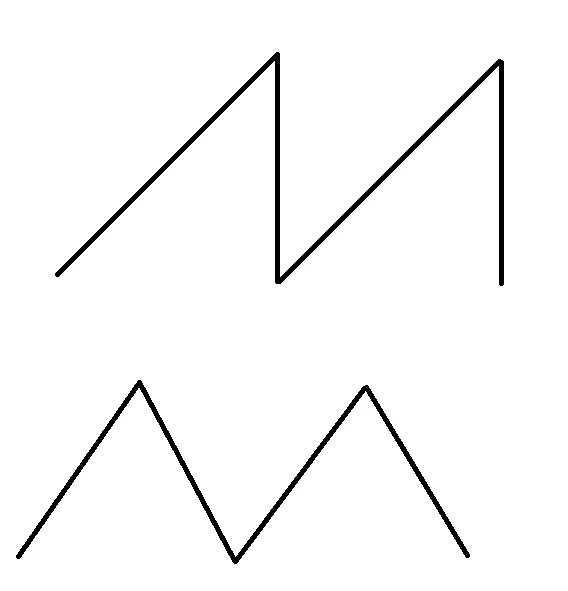

2. Then I will want to extend (if possible) to such waveforms, but still using heaviside step function (and also those waveforms needs to have laplace transform counterpart:
I do not know how my variant could look like, maybe something like this:
or maybe splitted in 2 parts, do not know:

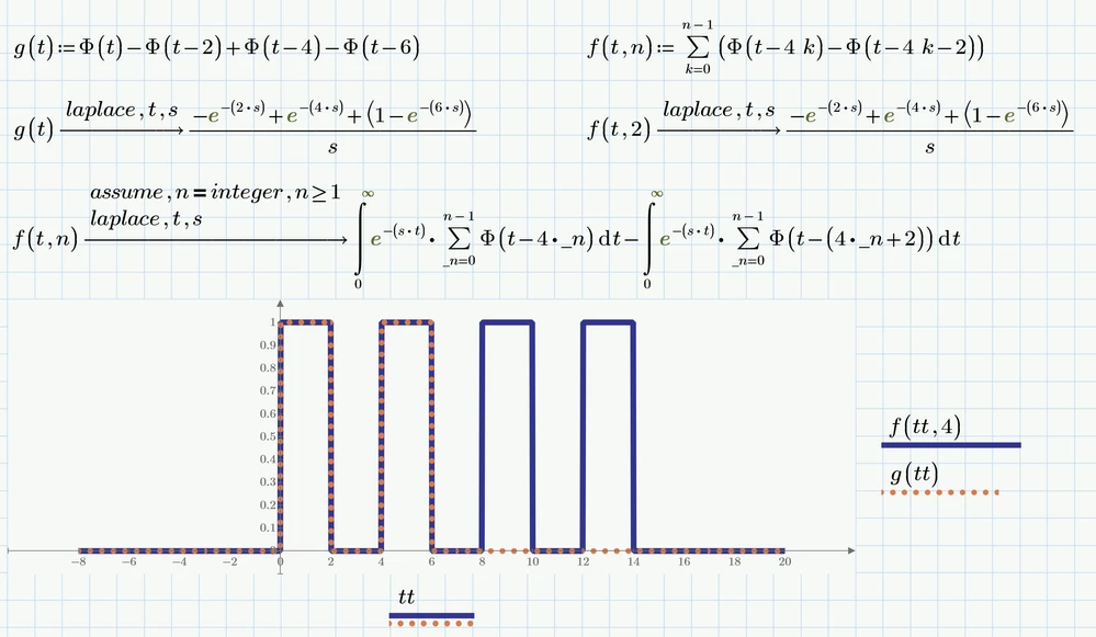

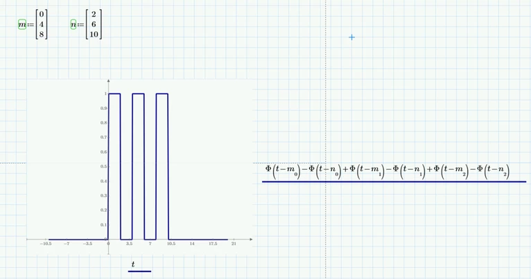

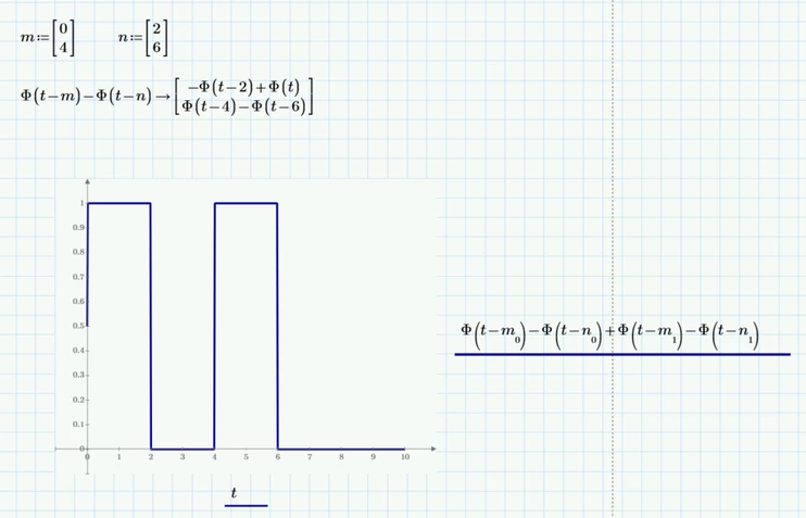

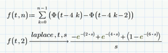

Cornel19-TanzaniteAuthor
Ok, its good also like this with finite number at this moment :
Now, how to make something like above f(t,n) for these kind of waveforms but using only heaviside step function:
Maybe that way:
