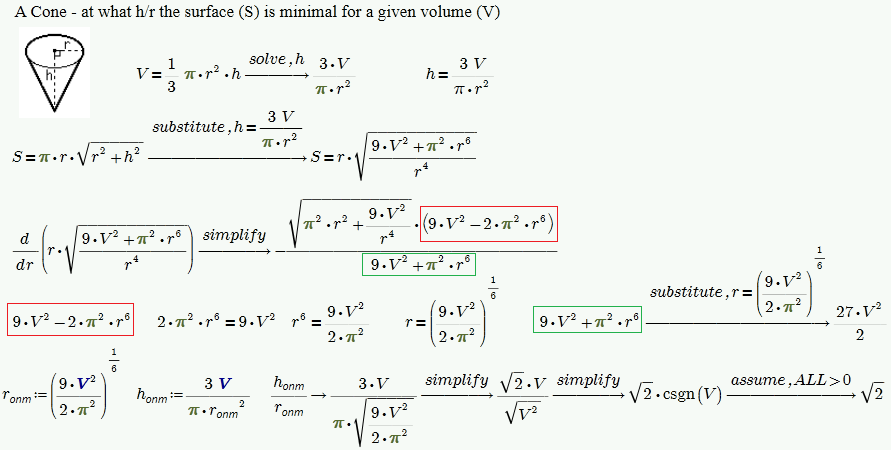

But the best solution is from Mathcad - a complex of symbolic and numeric math:
2%D0%B2-%D0%9A%D0%BE%D0%BD%D1%83%D1%81%D0%9F%D0%BE%D0%BB%D1%83%D1%81%D1%84%D0%B5%D1%80%D0%B0.png

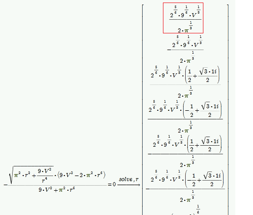

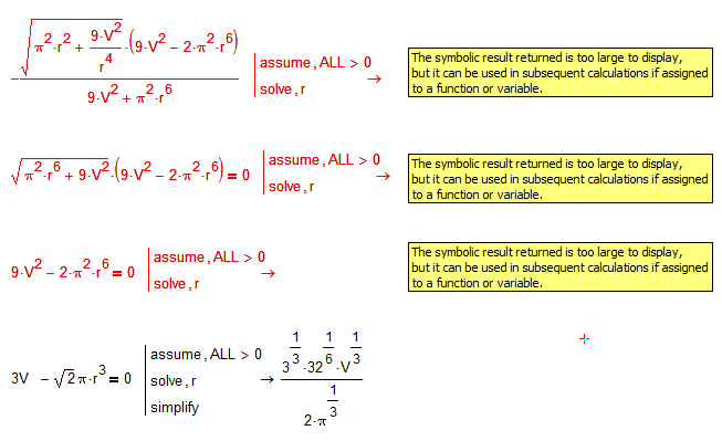

First thought was to use the modifier "assume,ALL>0", but the result is going crazy that way and i don't know why - sorry. You can only see it in the Prime version, as 15 say that the result is too big to display.
Maybe the conditions you see in doing so help you - they didn't help me understanding the problem.
At least you get a single result with "assume, ALL>0" if you assign V a value before solving.

Thanks, but it is not a solution. I need in the answer V not m.

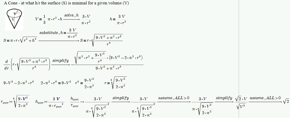

This is really a tough one (with/for Mathcad).
You have to simplify the problem by hand from the order 12 down to an order three equation to make it work - Blame on you Mathcad!

Thanks, Werner. I can do it "by hand" but I would like to do it by Mathcad for others same problems.

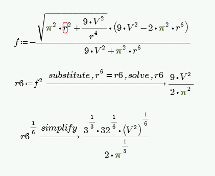

How about the following? It often helps to get rid of square roots! Still a little convoluted though!
Alan
Actually, you don't need to square f to get the above solution. I should have inserted a 'simplify' after f^2 to make it obvious (if it wasn't already!) that substituting r6 for r^6 is a sensible thing to do.

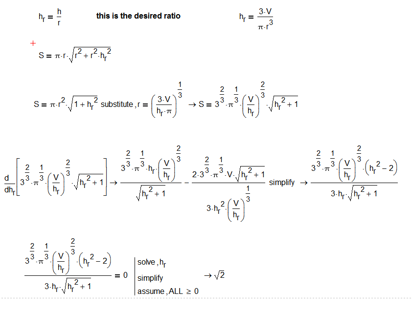

Reformulate the problem to find the ratio, not r. See attached and the figure below.

Valery,
Is the problem to minimize the surface to volume ratio of the hemisphere+cone? If that is the case, then the answer is for the h/r ratio to be 0. The sphere has less area/vol than the conical shape.
In your numerical example, you have specified the volume. In my attached worksheet I have given an example with h specified. Note that the plot of the surface/vol ratio increases with h.r = h/r. Also note that the derivative of the surface/vol rate never goes to zero. Thus, the symbolic solve can't find a solution.
