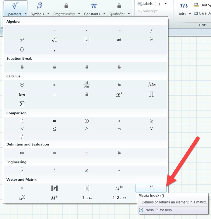

EDIT: The zero after "Match" is not a function argument so it does not appear in the argument list. Simply type an opening square bracket after the closing parenthesis in "match(....)" which is the keyboard shortcut for a vector/matrix index

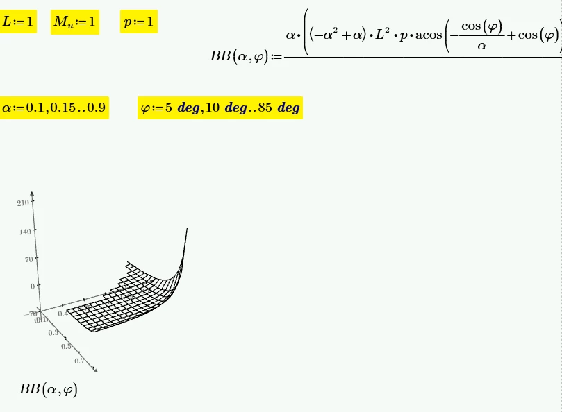

maybe, what if I was to rephrase the problem and instead of finding the zeros (which, from the figure that the other reply posted, doesnt seem to exist if I am looking at it correctly) instead I wanted to find the value of alpha and psi that results in the lowest value of BB? that is what i am trying to achieve here. I dont need to do it symbolically btw. Any input is appreciated.

So your function BB should be a function dependent on TWO arguments, alpha and phi? Is this correct?
Then a partial derivative wrt alpha would not have given you the desired extremum.
You would have to solve the system you get when you set zero both partial derivatives (wrt alpha AND wrt phi).
If you don't need a symbolic solution you sure can try to numerically solve the above mentioned system.
But you would have to provide numeric values for L, M.u and p !
Guess they should not all equal to 1 as ttokoro had chosen in the absence of a specification from you.
Once you provide numeric values, a solve block with "find" should be able to find a solution.
Another way would be kind of brute force. Create a matrix using a more or less dense net of alpha and phi values and use the "min" function to fund the minimum of all values. To get the indices of the corresponding alpha and phi values you could use the "match" function.
But again - this is a numeric approach and you would need to provide numeric values for the three unknowns.
A further option is to use the "minimize" function on function BB. You may use it in a solve block so you can add the additional restrictions for alpha and phi. Of course you still need values for L, p and M.u.
An additional problem is that your function BB may also return non-real values and you have to decide what to do with them.

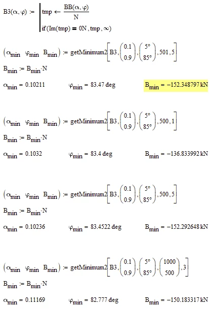

If you want them to be ignored by 'minimize' and 'min' you may define and use a function which sets non-real values to a very high value, like
To avoid having to evaluate BB2 twice you may use a local variable to store it.
Here in MC15

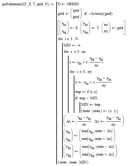

Finally here is a generic function for finding the minimum of a function in two variables by brute force.
Arguments are:
1) the function in question (should be unit-less in arguments and result)
2) a 2x1 vector with the low and high bounds of the first function argument ("x")
3) a 2x1 vector with the low and high bounds of the second function argument ("y")
4) either a 2x1 vector with the grid line numbers in x- and y-direction or a single scalar which is then used for both directions
5) a number which determines how often the algorithm should run. With each run only the small space around the minumum found in the previous run is considered, so this number indicates how far we zoom in. If the number is 1 the result is similar to what we had achieved so far by creating a matrix and using the min function.
To save memory the program does not create huge matrices and uses min on them but rather cycles through the grid, calculates the function value and keeps the smallest so far.
Examples show that its still important to use a larger number for the grid size because if the first grid misses the local min, further zooming in will not bring it back again. Its also quite sensible with respect to the grid number. 499 might give a good result while 500 may return a value not that good.
So experimenting and trial and error still applies.
Here is the function
And here some usage examples
MC15 sheet attached, the function is on the last page
