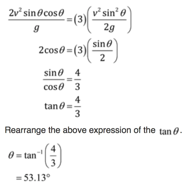

@kenan2 wrote:
Hi.
How can i solve for the angle and get it into a number not a matrix?

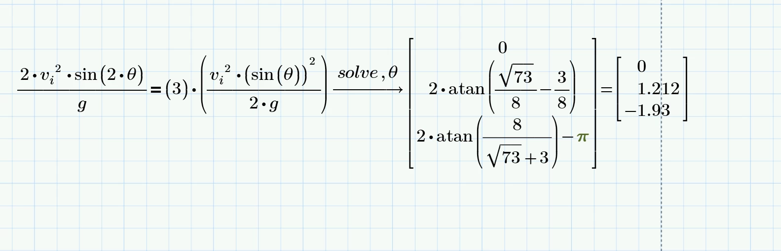

Your solution ARE numbers, but as there are more than one, Prime combines them in a vector.
Your equations has an infinite number of solutions. Mathcad shows you the three within the range [-pi; pi].
How should Prime know which of the solutions is the one you need if you don't tell it?

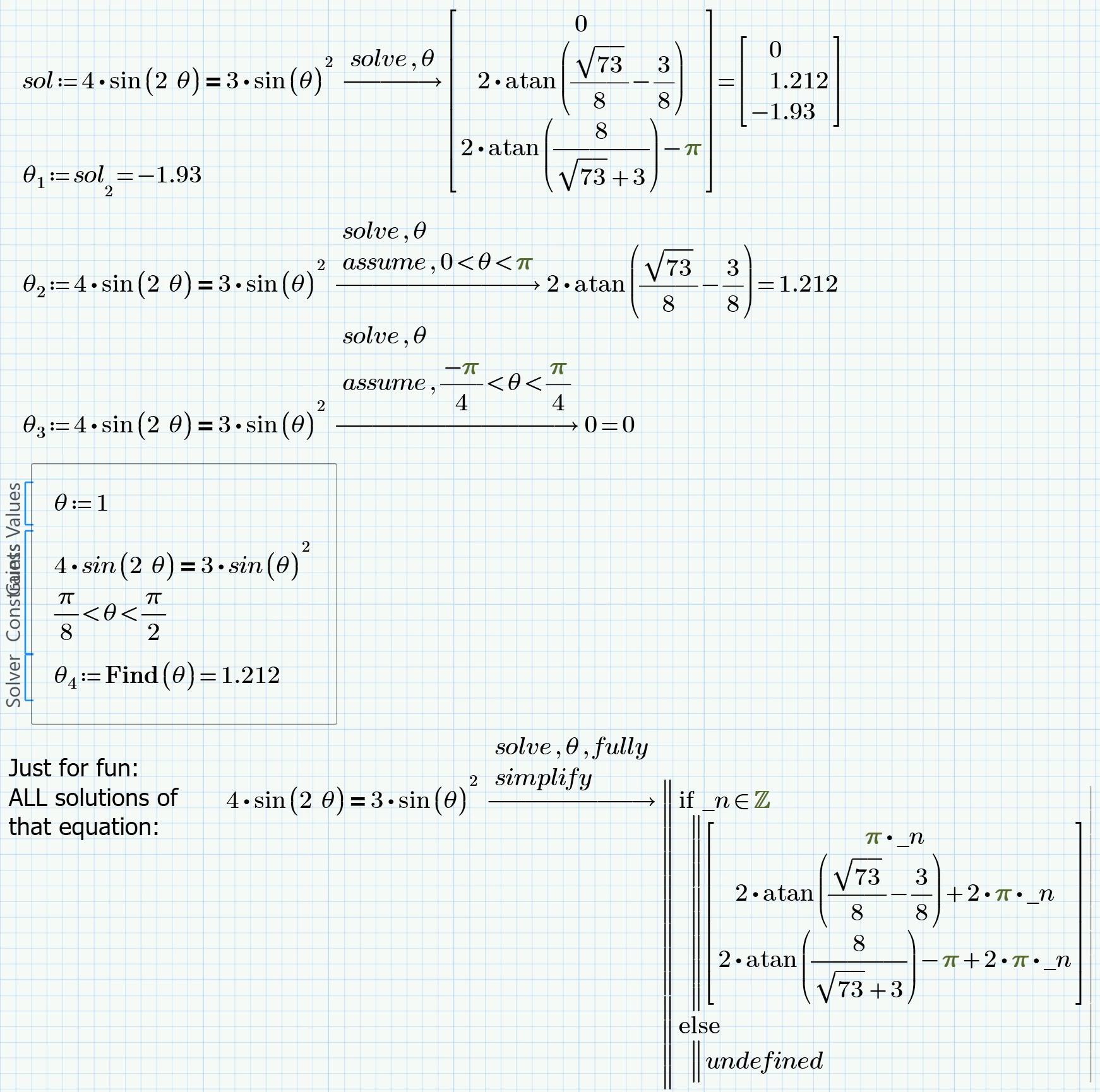

1) You may assign the outcome of the symbolic solve to a variable -> sol:=.... and then access the solution which is suitable for your application via vector index, e.g. theta := sol[2
2) You may use the assume modifier to only get the solution you are looking for, maybe like "assume, -pi<theta<-pi/2"
3) You may use a numeric solve block instead of the symbolic solve. Here you can apply additional constraints (like theta<0 or the like) and also control the outcome by using different guess values.

kenan21-VisitorAuthor
Jul 3, 2018 1:42 PM UTC
hmm.. Do not understand 😕
Can Mathcad Prime not reduce it like that (SEE PICTURE).
You have to be more precise as to what it is  that you don't understand
I hope - NO!     😉
1) In your first line you already have lost a factor 2 as sin(2x)=2*sin x cos x
2) In your second line you divide by sin theta and so you are loosing all solutions which are multiples of pi ( ...,-pi, 0, pi, 2 pi, ...)
3) In your third line you divide by cos theta. Fortunately cos theta = 0 is no solution to your original equation. Nevertheless whenever you divide you have to make sure that you don't divide by zero.
4) arctan 4/3 = 53.31° is just one out of an infinite number of solutions of the equation tan x = 4/3. You may add (or subtract) any integer multiple of pi -> tan x = 4/3 => x = arctan (4/3)+ k*pi with k in Z.

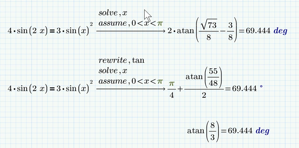

But Prime's symbolics is far away from being perfect and the solution Prime is presenting to you sure could be simplified but muPad (the symbolics in Prime) seems not to be to convinced to do so.
The solutions to your equations are:
a) any integer multiple of pi -> k*pi with k in Z
b) arctan(8/3) + k * pi with k in Z
The expression Prime gives you is more complicated but its perfectly equivalent.
And at last again: Your equation has an infinity number of solutions. If you expect a specific one (maybe 69.444°) you will have to tell Prime so (e.g. via the assume statement). If you want to see the angle)s= in degree, you simply have to type deg or ° in the placeholder after the result values. Using the degree character ° is more complicated in  Prime than it is in real Mathcad - you can't use the keyboard to type it in but must chose it from the "Units" dropdown.
As you can see in the picture Prime delivers the very same result in a quite different notation if we rewrite the equation with tan functions before we solve it. I was not able, though, to convince Prime to simple give us atan(8/3) which would be the most simple way to write that solution.
