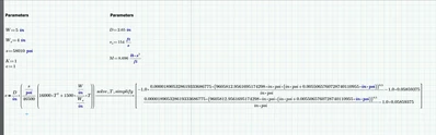

I am having issues with the solver not simplifying the units of my equation (file attached)- does anyone know what may be causing the issue?
I'm using Mathcad Prime 9.0.0.0

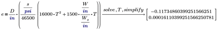

The problem is that Prime's auto-labelling is doing wrong by labelling some of the used units as unit and some as variable (you can tell so by the typeface and color). The symbolics does not know anything about units and treats them as undefined variables. And a unit "in" and a variable "in" are seen as different and can't be cancelled.

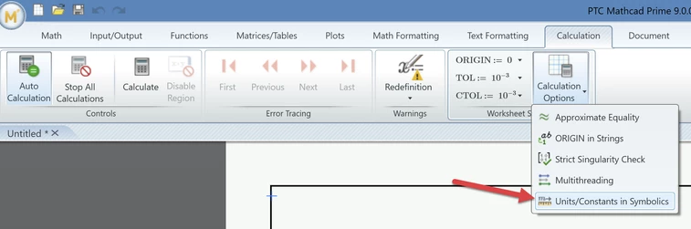

You should turn on the option "Units/Constants in Symbolics" in the Calculation options and then recalculate the worksheet.
In your case this solves the problem
Nonetheless the symbolics still does not know anything about units.  In your case these 'variables' cancel and so you get the result(s) you expect.
Normally you would have to follow with a numerical evaluation to simplify the units.
Here in the example I replaced psi by 144 psf and you can see that the symbolics is not capable to simplify:
