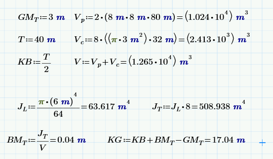

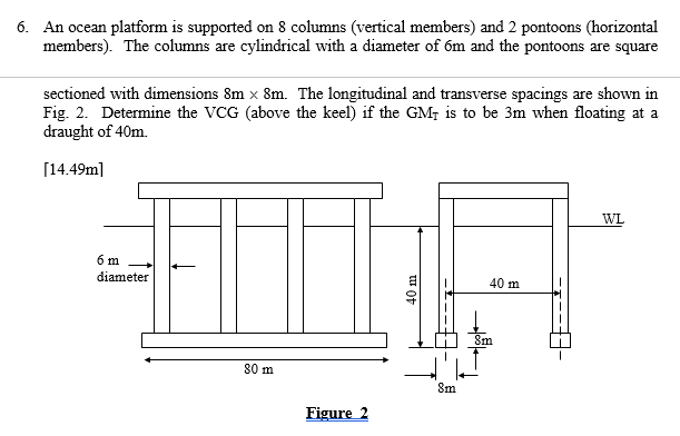

Tonight I am attempting the below problem:
The given correct answer is given as 14.49m for the centre of gravity from the keel of the platform i.e. KG=14.49m
I have so far approached this as follows:
I.e. the transverse Gravity to the Metacentre is equal to the Keel to the centre of Buoyancy + Centre of Buoyancy to the transverse Metacentre - KG.
I.e. KG=KB+BMT-GMT
I have also worked on the assumption that:
i.e. BMT is equal to the transverse second moment of the water plane divided by the underwater volume. I've also assumed that the KB is half the draft.
Further I have assumed that as the cylindrical columns are at the waterplane, the second moment of these areas will be about a circle and can be calculated as:
Capture.PNGi.e. Pi * diameter to the power of 4/64.
I have carried on as below.
I think that I have calculated the underwater volume correctly and the second moment for one column correctly. I am not sure how to equate the total second moment for the total waterplane i.e. all 8 columns. I am sure it is not as simple as multiplying by 8 as I have done?

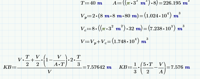

So Obviously I am still working through this.
So far I have managed to work a proper method of calculating KB using Morrish's formula:
This I can believe is more realistic as most of the underwater volume is at the base of the structure.
I also realised that I had an error in my units so now the area of the waterplane should be correct.

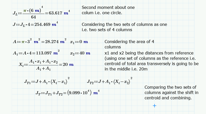

I have also looked at refining my approach to second moment of the waterplane as below but am not convinced this is correct.
So basically I am still stuck and open to help/ suggestions.

Just to add, I understand the basics of ship stability.
The math indeed should be easy by following the simple concept of KG (Centre of Gravity to Keel) being equal to (KB + BMT) - GMT.
I believe I have calculated a relatively accurate KB using Morrish's formula for KB as above.
The area I am struggling with is calculating BMT which I believe to be equal to Jt/V i.e. the transverse second moment of the waterplane divided by the underwater volume.
I believe I have calculated the underwater volume correctly, but I am struggling to calculate the transverse second moment of area for the waterplane. I believe that the transverse and longitudinal second moments for a circle are the same and I think I have calculated second moment for a single column at the waterplane i.e. a circle correctly. What I can't get my head round is calculating for all 8 columns at the waterplane. I think this is a form of parallel axis theorem, but am struggling as the areas are obviously not connected. As I say above, I looked at this by way of calculating two sets of 4 columns and calculating about the transverse centroid of the waterplane i.e. the middle of the two sets of 4 columns.
Originally I thought about calculating second moment for each set of 4 columns but the question does not give the longitudinal spacing of the columns so do not know the X value i.e. the distance between the centroid of each individual column?

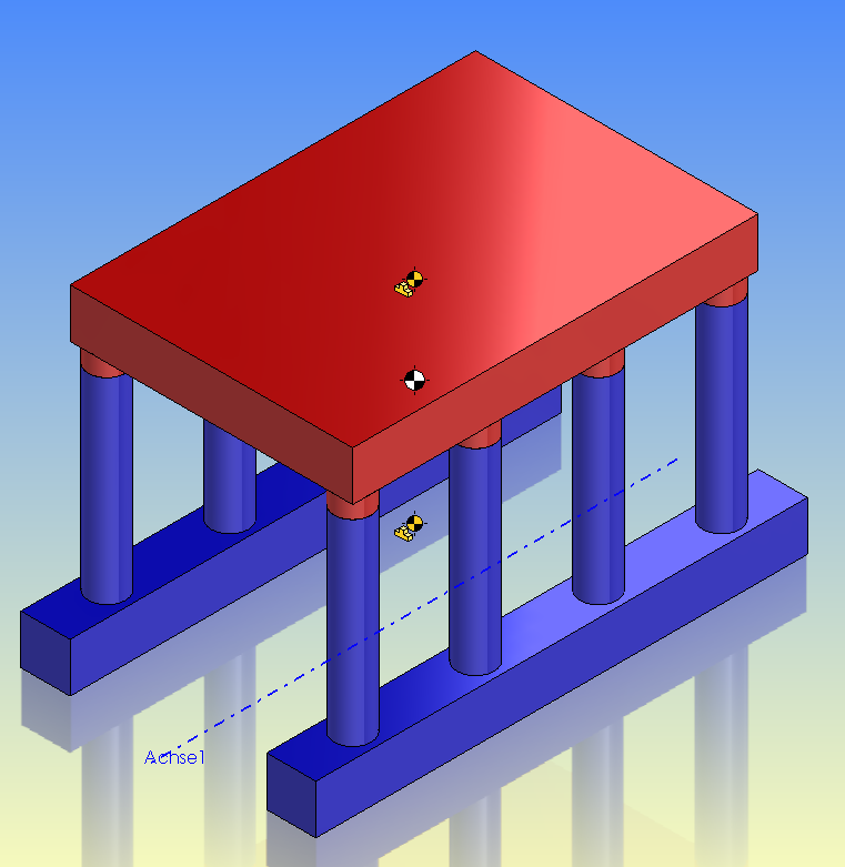

can you give me please some measurement (see attachement) ?
I found something interesting about Titanics stability here: http://titanic-model.com/articles/A_Matter_of_Stability_Trim/A%20Matter%20of%20Stability%20&%20Trim.pdf
best regards, Volker
awibroe1-VisitorAuthor
April 11, 2017
‌those measurements are not given.

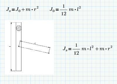

Hi Andy,
When rotating a rod, in common we have to take into account the Steiner-moments.
For instance:
where "r" is the distance to the center of gravity of the rod.
April 11, 2017
‌nnot sure I understand the application of your diagram to this problem?
April 11, 2017
is it a dynamic problem?
If it's a dynamic process, when the platform rotates around the longitudinal axis.
If you don't have all important measurements, how will you calculate it?
