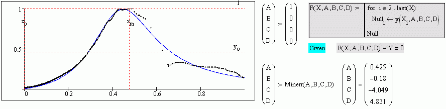

Why don't you bother to check your results actually work? If you plug A, B, C, D into your function for Y at that point you get Y=0.225. The actual value of Y is 9.127*10^-4. So, once again, your conditions are not consistent with your data and/or model. Of course, something you omitted to tell us was that your Y has actually been normalized to 0.01, not 1 as implied by your conditions, but even if you multiply the measured Y by 100 it's nowhere close to 0.225.
Is it true that each column of X and Y is a stress-strain curve for one sample? I wish you had made that clear from the start (or that I had realized it!)! That means, contrary to what you implied, A, B, C and D are not different for every point, but only for every column. In which case Alvaro is right. If the data is a stress-strain relationship with one column per sample then the right way to check the model is to fit the model to the data. It is possible to do it your way, but it's a very bad approach. All of that work was unfortunately just a big waste of time.
Alvaro fitted the entire data set, including the data after failure. If the model is only supposed to represent the data before failure, then you should only fit that part of the data.
Richard

I know that you know what can be done with the data and in which way. In the attached the same, but normalized as you discover the strange normalization in the computed values, and the observation that data is not sorted, at the point that there are negative values for the normalized X. I understand that the origin can be set to the arbitrio of the experimentator, but if always have a load, why take an origin which results in a change of sign in the deformation? So, can re-re-normalize substating the minimun to hold X in the range (0,1), but I don't do this in the attached.
Regards. Alvaro.

I think the idea was to normalize the data so that (1,1) is the fracture point. If that was the intention then it's clearly not as simple as picking the point with maximum load though. Data set 2 shows clear evidence that the fracture starts before the maximum load is reached.
Richard

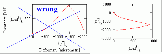

>is easier to read the independent values on the horizontal scale and the dependent ones on the vertical one.<<br>
The independent variable is the pressure you apply, it plots on X
The dependent variable is the deformation, it plots on Y
You should worry most about the data you have collected, many of them show an unexplainable pressure cycle. Some you can defend and I can accept, typically the one I have worked. What you are not saying is about the pressure cycle you apply or attempt to apply [I mean the ones that makes sense]. That pressure cycle pattern, does it comes from a standard in that kind of testing or does it come from some invention. Up to the fracture, if you apply a linear pressure, it will surely fit well.
The other point is that you will not interpolate via "linterp" or a bspline [interp] on the non ascending part of the pressure cycle, unless the data are split and transformed . The attached demonstrates how to interpolate the ascending viscoelastic sites. The part after [polyline] is for a total pressure cycle in parametric form.
>My main goal is to see the best curve to fit experimental data. That is why, in the first place, I'm studying what others have proposed (i.e. Wang et. al). <<br>
The best fit up to fracture will largely depend upon the ascending pressure . When you plot sin(x), x is supposed linear. Sometimes transforming the independent variable helps the fit. You refer to Wang et al. but you haven't attached the PDF or else link to what you are reading, just to make sure it is understandable, and technically correct. Does Wang give the form of the pressure cycle or is it an invention. Why don't you make it linear up to the fracture ?
The last plot is a 2/2 rational approximation.
jmG

As dvmoldovan already explained, the experiment was constant strain. The load was adjusted to keep the strain increasing linearly. So the dependent variable is the load.
Richard

Mathcad is essentially a 0 ORIGIN based tool. Changing ORIGIN to 1 will result in many collabs not even considering the project. If you have done too much maths in ORIGIN 1, don't expect collabs to make your maths work to accommodate their help in ORIGIN 0. Your plot are in the reverse order, i.e: the independent variable "Load" plots on the Cartesian X and the dependent variable [deformation] plots on the Cartesian Y. The way you plot is not visible by inspection and it has to be re-plotted. Your data are still very confusing. No matter how much I have done, nothing is correct on the ground that you don't apply linear "Load pressure" but on a ramp basis, and some "Load pressure" are totally non sense. That means that fitting will be lot more difficult if the independent experimental variable is not linear. Explore the next graph and check the data that must be rejected. Altogether, there may be only one data set needed, and here again why not linear "Load pressure". So, before any math processing, make sure to consider only one data set for only one specimen. Then decide about more specimen and either check the "Load" is correct or run the experiment again. But in any and all cases, you have too many values from lab test::: What you are doing with the ramp load, you are collecting [stacking] a fine and a coarse experimental data set and that is not correct because for analysis, the collection has to be reverse engineered, undoing what shouldn't have been done in the first place.
This project looks simple but it is upside down.
It could be that the rational fraction represents the viscoelastic model for concrete. It shouldn't be more difficult to solve than the simple Maxwell model. As it looks, you are applying a pressure cycle but of such bizarre shape. Why not a simple triangular cycle. That would render the project visible by inspection with no torture of the mind and eventually with a non mirror return of the decreasing load, the deformation might be meaningless.
"In this pressure cycle that does NOT make sense unless justified, it can be seen that the deformation has in some ways followed the pressure load. In simple words: the specimen experimented is 'elastic'. "

The Minerr Paul W. was passed in two styles: the short style as in the work sheet in reference, and the NULL style. The fastest when it works is the short style. However many fits will not be possible in short style, so here is the NULL style. The vector of initial values must be collected in vector, this is so because lots of fit can't go direct LM but a good approximation is obtained sometimes CG, sometimes QN ... thus much easier to plug coeff's. And because there is always an "AND", too many fits can only be done manual, thus you must be able to collect quite a few fits in vector.
In Mathcad it's best practice to respect the position of the arguments and parameters. Nothing wrong y(x,A,B,C,D) but it's not correct and creates lots of problems especially in collaboration ... it should be y(A,B,C,D,x).
Same remark about ORIGIN that should be left 0.
To fit a "normalised rational", only the first term need be valued, generally the value 1 is OK. Not detrimental in this 0...1 range of 'x' but it will soon fail with a much higher range of 'x' because if the higher order monomials are valued it pushes the solver out of capability.
Nothing wrong with the work sheet in reference, but not a model to follow, at least not for beginners learning "curve fitting" in Mathcad.

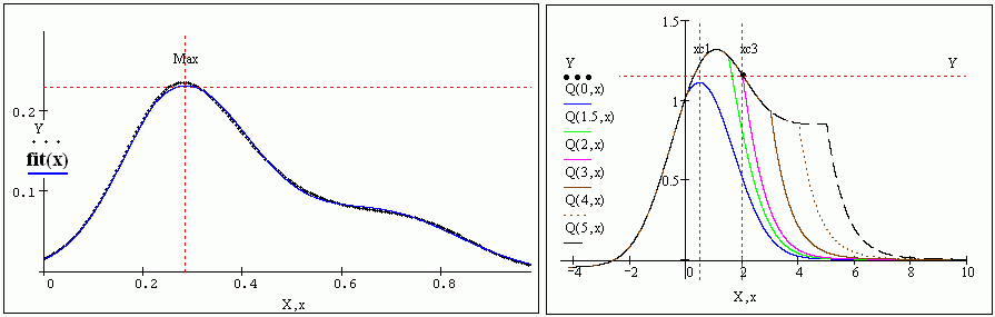

... suite demo:
This fit is in 4 steps of PWMinerr LM [Levenberg-Marquardt]. Yellow is the initial guess, and on that there is no maths or very little in some instances, the second step is to re-inject the first found coefficients ... there you can see my point about copying a vector vs the individual inclusion like it was on other work sheets ... and the detail in there is that often just by acting on a single coefficient, Mathcad will crash or end in an infinite loop !!! Nothing is so simple, but a good procedure helps.
Done the green fit, next step is to force the fit, here j 216 [typical] ... not too bad but can be made better, how ? No matter how smart the numerical maths are, non-linear models are "reflexive". What it means here is that xc does not Minerr, Oh l�, l�. You are then left with a manual touch up of xc, while you can still play with j 216. The result is a non arguable better fit than Wang rational that is not very flexible.
In a paper, you can put the coefficient in an horizontal vector, but at the design and construction stage, if you don't leave the procedure operative, collabs have to deconstruct. You can stick with Wang but in my opinion you shouldn't refuse a better model. Often, there is no alternative than an "approximation", however in case a better model is found it should change religion.
This message and the work sheet in < 15 minutes.
