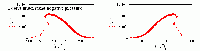

"1. from experiments one has gathered data for strains (column 1 - microns) and the response in stress from the material (column 0 - newtons)"
==> Total non sense: strain is a calculated ratio, dimensionless.
I don't understand negative pressure unless the sensors have inverse polarity or the calibration is zeroed at 2500. But you can see that the project is reversed. So, we are back to square 0, i.e: read the pressure from a dial meter and the deformation from a dial meter too, with much less measurements.

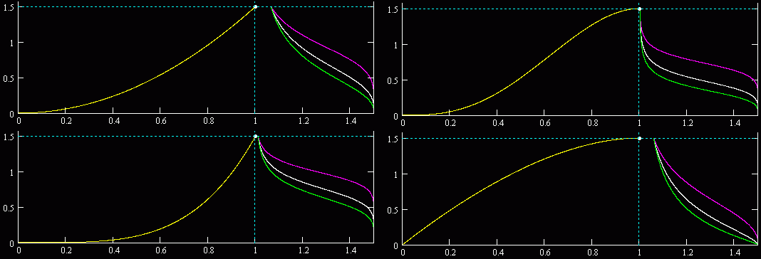

May 9, 2010
... more graphs
jmG

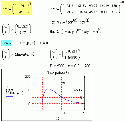

Here is how to use the (A,B,C,D) fraction you attempted unsuccessfully.
May 9, 2010
On 5/9/2010 9:14:16 AM, dvmoldovan wrote:
>Great work! Thanks!
____________________
Don't get discouraged by curve fitting. Over 40 years of that stuff didn't quench my appetite. Build that one by yourself and try the full data set or the two points reduced one. Notice the Minerr is not vectorized,,, Oh ! something new. Now, assume the underlying phenomenon is of that shape, no matter how many zillions of points, you won't get any better fit than the two points one. This example is an "ad absurdum" proof that data set must be collected wisely. It dictates pre-testing to evaluate the shape of the phenomenon, then distribute at best. In term of your project, 1791 points is non sense, simply. Ideally of equal length and not more than needed, strictly raw data from what you apply and what you read.
In that example, an abundant data set can be plotted and the fit governed by " a user two points" for a customized fit based on some known bias from the collection or simply based on a special calibration point, that would then be a "calibrated fit".
jmG

What you are saying is that up to fracture you have concrete and past fracture you have chewing gum and that eventually there will be sometimes a new concrete recipe that will not collapse like the 911 towers. The matter is then to collect the pressure and the deformation from analog meters or recognized equivalent A/D reading. Then, from whichever best fitting function, you will conclude the "stress-strain" diagram. You seem to forge data the way you want to arrive at a false proof and want collab to approve your work.
Again, two columns of about 2 dozen of paired stress [pressure per unit area] vs the deformation [in applicable unit]. From there, it will be possible to best fit or otherwise provide a clean relationship from which you will extract the "stress-strain" conventional diagram.
jmG
