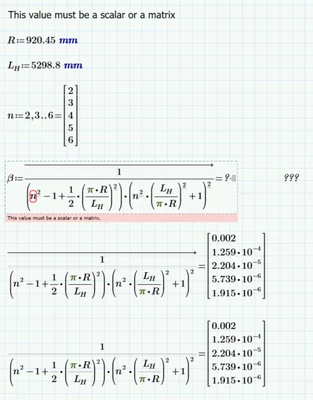

I am getting the following issue on Mathcad 10:
"This value must be a scalar or a matrix"
I am looking to define the output matrix as β. It seems to work on its own but not when I try and assign it as β.
It isn't an issue when run on Mathcad Prime 8 or 9.
Help would be appreciated.

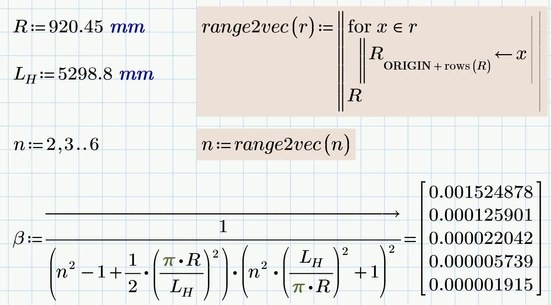

The behaviour of the evaluation operator (=) changed in Mathcad Prime 10.
Previously, when defining a range, using the = operator converted the range into a vector.  In Mathcad 10 it no longer does so; hence the error message when you try to use n.
You will have to explicitly define n as a vector, or create a function to convert a range variable to a vector.  Try the vec function defined in this link:
https://community.ptc.com/t5/Mathcad/The-vec-function/td-p/170273

You should not use a range - use n as a vector !

Stuart already explained why this problem occurs in P10 and how to solve it.
Inline evaluation does not convert a range into a vector starting with Prime 10. So even though you use inline eval, n remains to be a range and so the assignment to variable beta fails.
PTC's decision to make the (admittedly illogical and inconsistent) option of converting a range to a vector impossible without providing a more sensible inbuilt alternative is regrettable.
In case you are still unsure here your file in a working variant.
I used a simpler variant of a range-to-vector function, for more capable and sophisticated versions follow Stuart link.
Of course you could also define n as a vector right away. Either using a  global range variable
or using a programmed for-loop
In some threads in this forum you will also find user-defined functions to create a vector by providing first, second and last value (similar to the definition of a range) or also by providing first value, step value and either last value or number of entries.
