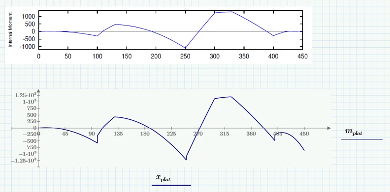

I am trying to recreate a matlab program in mathcad and the only part I'm struggling with is finding a simple replacement for the matlab cumtrapz() function. It is explained in detail here and here.
So what I have are 2 vectors containing x and y plot points for a shear forces graph. I'd like to generate the moment plot points which involves getting the cumulative integral from one plot point to the next. I'm looking for the simplest way to do this.

As you are looking for a replacement for Matlabs "cumtrapz()" function - wouldn't simple linear interpolation do the job as well?
https://support.ptc.com/help/mathcad/r6.0/en/index.html#page/PTC_Mathcad_Help%2Flinear_interpolation.html%23
It looks like you are not looking for the vector result of cumtrapz() but rather for a continuous function. Using linear interpolation you might do it like that:
Remark: You shouldn't use the same variable as integration limit AND integration variable, therefore the xi - you may replace it by c or anything you like.

Thanks, I think linterp is simpler and achieves the same thing in this case.
I don't know if this is due to the difference between how matlabs cumtrapz() and mathcads linterp() work, but I'm having an issue with my plot matching the output from the matlab program.
August 11, 2020
Your Moment plot has vertical components at each support point where it should be equal each side of support.
This means you are not allowing for unequal reaction at each support left or right.  this accounts for the value on the right hand end not being zero.
Moments are usually plotted on tension side so you should plot -m to show this,
