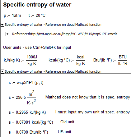

I have same problem in my thermal calculation and solve it so - see the pictute and attach.
