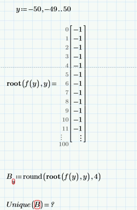

Oct 4, 2024 2:25 PM UTC

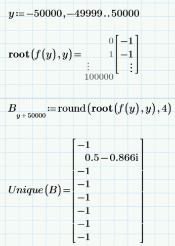

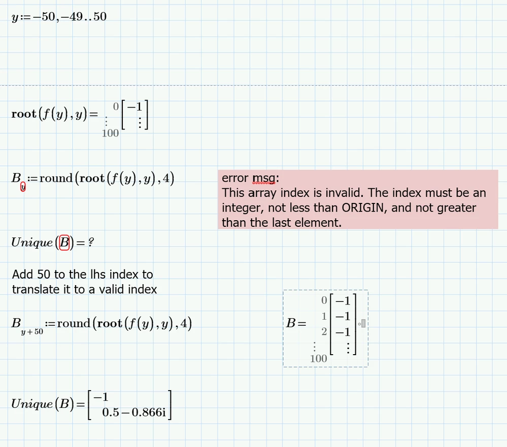

y runs from -50.  Indices have to start from ORIGIN.

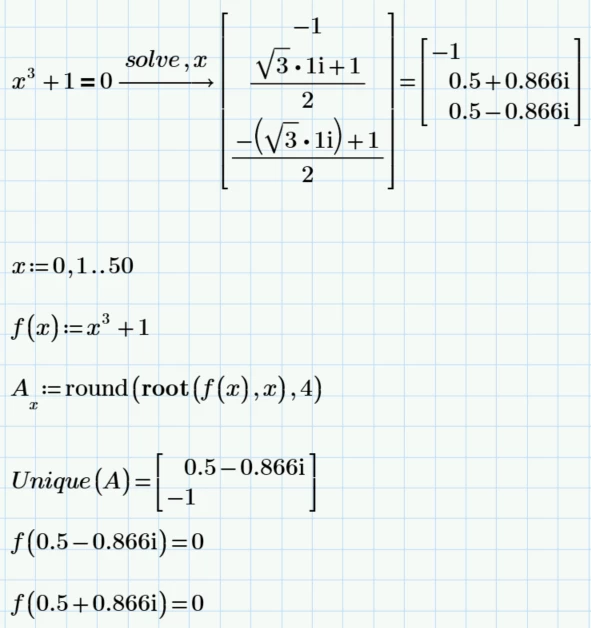

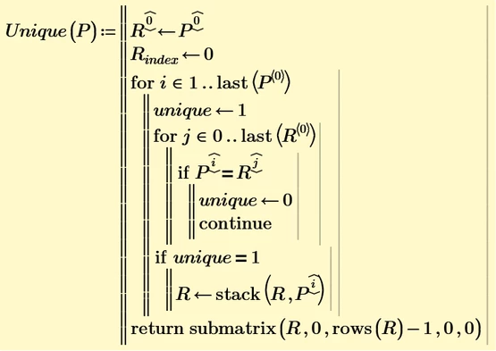

Ok, but still one solution is missing:
The second imaginary solution:
I don't know why this solution it is not catched/found it...

Oct 4, 2024 2:41 PM UTC
I understand. Also, I can use solve command and received all 3 solutions.
But I want to understand why in the way as I shown above (with x as a range, and with root function), this way does not find the second imaginary solution as I should be the case.

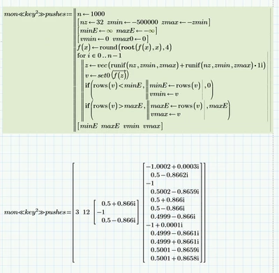

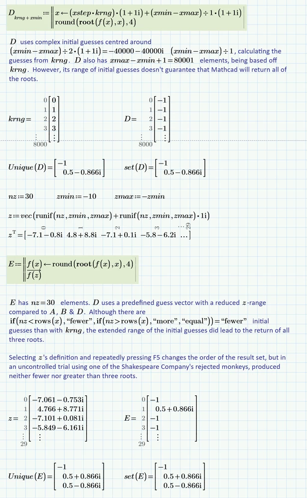

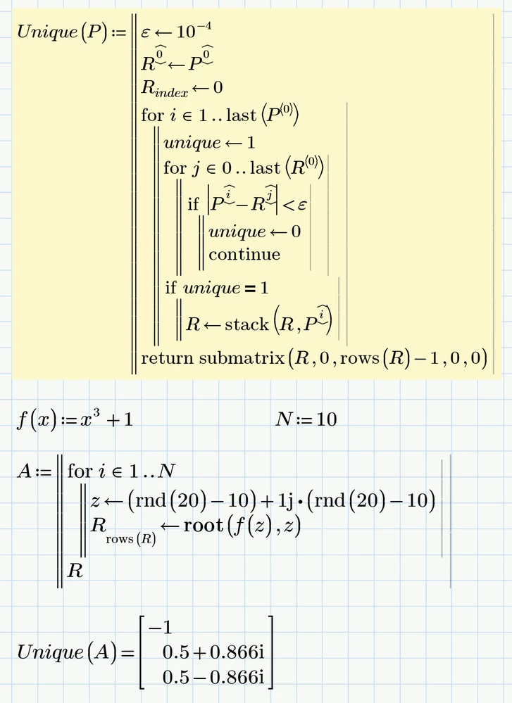

I was a bit surprised to see that root would even return non-real results with real guesses.
Here are my 2 Cents, using random non-real guesses.
23-Emerald V

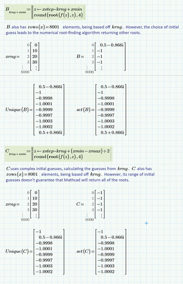

Oct 5, 2024 2:22 AM UTC
Now that's interesting.  When I tried that, Mathcad squawked like a parrot on a sugar high.  "No, take that nasty complexity out right now! Honestly, some people. Pieces of Eight. Who's a pretty CAS. The horror, The horror ...".
The local definition I used above arose from such an attempt. However, with freshly typed expressions this time, the parrot was rather quiet.
Reducing the range over which root searched gave better (for values of "better") results.
I blame any typos, logical errors and programming mistakes on it being Oh Dark O'Clock and sleep deprivation taking its toll.
