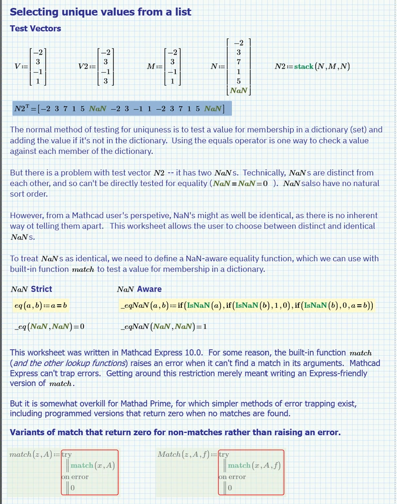

I was playing around with sorting and decided (yet again) that I was frustrated by some of the restrictions.  One thing led to another, and before I knew it, I was hip deep in ways to "improve" the lookup functions.
While contemplating Mathcad Zen Principles 3, 6, 7, 16, and 17, I wondered whether "unique" would be a worthwhile addition to the match/lookup modifiers.
Then my mind went blank when faced with how to handle NaNs.  In principle,  IEEE 754 NaNs are distinct.  And they would be if a standard Mathcad user had any way to distinguish between them, but they're harder to tell apart than Zathras and Zathras.  To the Mathcadder in the street, they might as well be indistinguishable, for all the good their distinctiveness does.

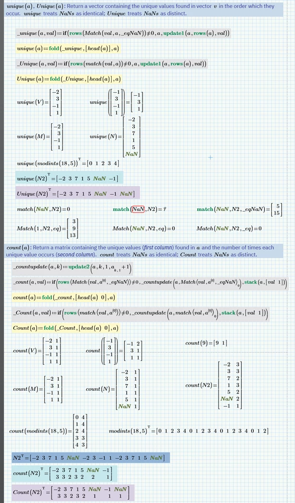

So, I've written two versions of unique to cater for both cases.   The question is which one would a user expect to be the default (and hence all lowercase) version?
I've checked in a few other languages.  Matlab seems to be an outlier in treating NaNs as distinct.  Python (numpy), Julia, and (surprisingly) Mathematica appear to treat NaNs as indistinguishable from each other (for uniqueness testing); even XCas does so: set( [1,2,4,5,NaN, 6,2,NaN,5,1,4,2,5]) == 1,2,4,5,NaN,6
In the meantime, could a kind soul please check whether the attached Mathcad Express 10.0 worksheet works in Mathcad Prime?
I'd expect the results to look something like this:

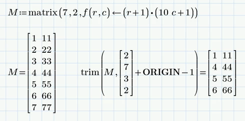

And a follow-up question?
What does the Mathcad Prime function trim do if it has replicated indices?  Does it only delete the one instance of index k in vector v?  Or does it, say, delete vk  at the "new" index k after deleting the first vk?
•trim(v, vindex)—Trims out the entries (rows) specified by vindex.
Stuart
23-Emerald V

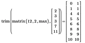

The function trim() operates as follows:
So it doesn't throw out the 3 AND the 4, only the 3.
See attached. Also observe what happens when you change ORIGIN (before all function definitions of course).
The same goes for the built-in "trim" function

When you define "match" and "Match" you have to decide whether the formal argument name should be "x" or "z" 🙂
And function "_eq" is not defined, only "eq" and of course "_eqNaN".
Later in your sheet you use both "eq" and "_eq".

Thanks, Werner.  That's why it's always good for me to check things.
'z' is used as the formal argument in the match/lookup Help, so I'd go with that.
Copy & Paste error for _eq and eq.  I use the name _eq specifically for my match implementation, and eq for a named equivalent of the = operator, but I copied the wrong definition below _eq.
