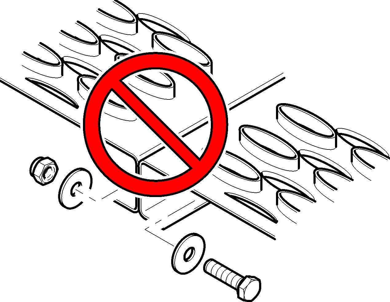

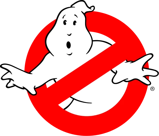

Is it possible in IsoDraw to create a "GhostBuster" symbol that would require deleting portions of a color filled circle? Essentially create a circle, fill with color, delete portion of circle to create the slash symbol commonly seen when illustrating "DO NOT DO...." I want to be able to place this "symbol" over other items with them showing through the cutout portions.
Thanks is advance.

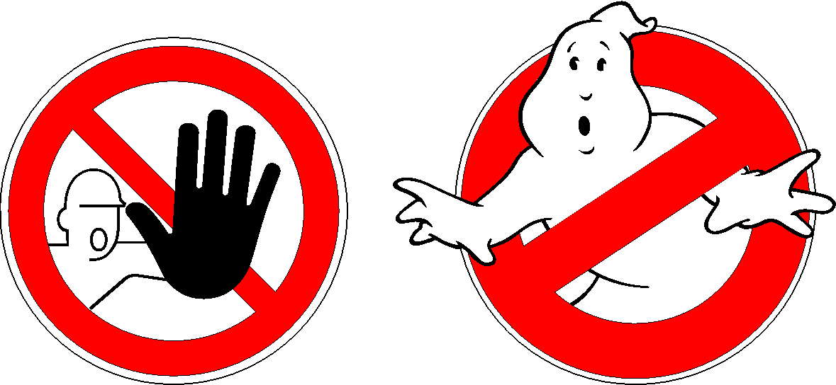

Why not ... that's one of the points why IsoDraw is made for ...
... Now I understood, what you mean ... you need that without the ghost. Much more easier. See example ...

Yes! The bottom illustration is what I am looking for. How do I accomplish that? To remove the two inner portions so visability is achieved behind the symbol?

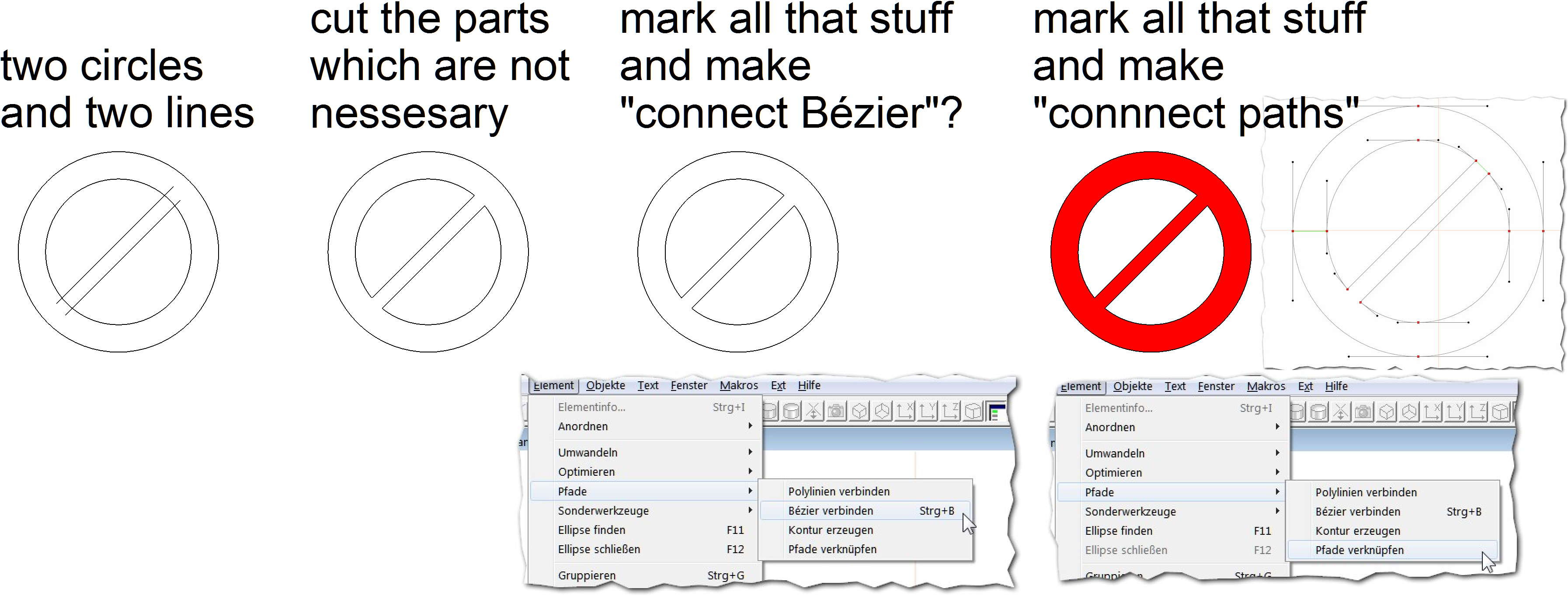

Hope that helps. I don't know how the Menues are called in englisch. I only got german screenshots ...
  1. two circles and two lines
  2. cut the partswhich are not nessesary
  3. mark all that stuff and make "connect Bézier"
  4. mark all that stuff and make "connnect paths"
  5. Fill it with color and set for example the outlines with shadows etc.

If you want the two inter halfs transparent, don't you have to select all three objects and make them a compound path in the Element/Path menu?
TomR
January 9, 2015
yes the last step is to create a compund path. Markus is using the german version so I believe there was a little translation issue.
