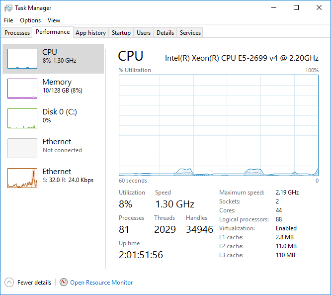

March 29, 2017
Ok maybe there is a misunderstanding.
Creo is talking about Maximum threads of 64.
In our understanding this means that 64 cores (not cpu´s) can max. solve a calculation.
Therefore we decided to buy this Workstation with 2x22 cores means in total 44 threads.
But the solver is just using maybe 20% of all cores and not all 44.
So why is PTC talking about 64 threads?
I cannot see this.

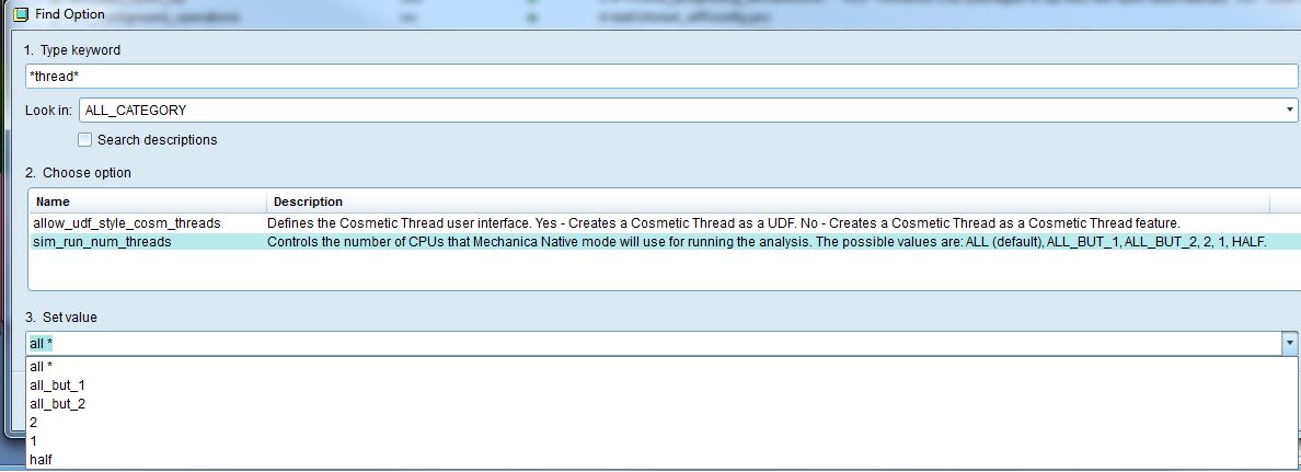

March 29, 2017
Try to look at this option.

A brief moment of clarity:
from the pic you can see
2 cores
44 cores
88 logical processors (threads)
You can see here, for example, regarding logical processors.
So, in theory, you have 20 threads more than the maximum.
Given the above, which kind of analysis are you doing?

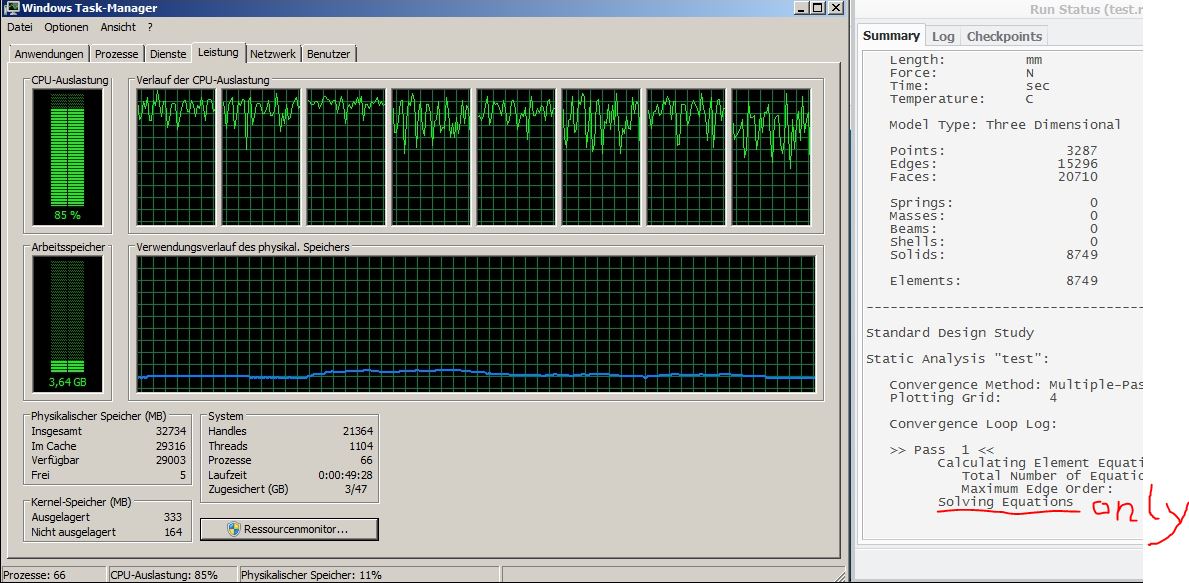

March 31, 2017
‌thank you for this reply. I totally agree to all of your comments but I stikl do not understand why ptc is writing that simulate can use multithreaded taskes! when I run a simulation I always see how high the usage of the coy load is and there is almost no high load. That means that only a view cores are used and this is nit comparable to the note from ptc. I have tried several different types of simulations and it is alwa the same. If so you can never accelate your calculation speed isn it? What should be the best hardware setup in your opinion?
skunks
March 31, 2017

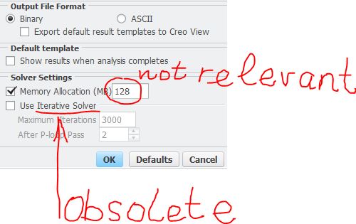

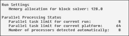

hi,
block solver of simulate can use multithreaded taskes:
and standard settings:
regards

skunks
May 16, 2017
hi,
block (direct) solver is standard (multithreading automaticaly).
iterative solver is obsolete:
Attention:
Creo 3.0 M120 and later: multithreading is out
regards
paul
