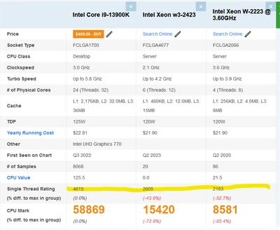

It seems as if our IT dept has decided independently that they can save a lot of money on getting computers with slower processors as long as the processor has a good Turbo speed.
I've never paid much attention to the Turbo speed when specifying a processor for Creo.
What are the thoughts on Creo using the processor Turbo?
This is a co-workers new workstation, I'm going to ask him to run the creosite benchmark on it and on his old computer too.
I just can't imagine this being an upgrade, but maybe I just need an education...not sure.
The processor in our specific situation is a Xeon W3-2423 2.1 GHz base speed. My current workstation (~3 years old) uses a Xeon W-2223 @ 3.6 GHz base speed.

I'm sorry but both of those Xeon processors are not good for Creo performance. As has been addressed many times in the community and with PTC, Creo is MOSTLY single thread processing. I use the Passmark website www.cpubencmark.net to compare cpu's. I would tend to i9 or even i7 processors. There are other differences between computers designed for Xeon vs. the Core series that might favor the Xeon's but the difference in the single thread performance is so stark I would recommend the (by the way cheaper) Core series. The i9 in the comparison I'm posting is what is currently spec'd for our engineers. Even the newer Xeons are not as fast in single-thread operations.
If you can, I would also recommend trying to get loaners of the computers you are considering and try running the OCUS benchmark (www.creosite.com)

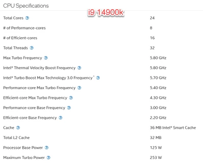

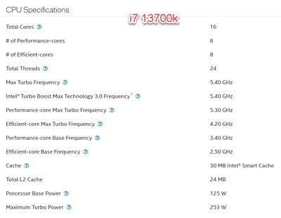

When I look at the i9 core, I see 7 processor speed. An i7 processor speed "base" is faster but max turbo is slower. Comparisons are more difficult than they used to be. Does Creo actually utilize Turbo within the processor, or better question, how does the processor determine what runs at all the levels turbo that it offers?
January 23, 2025
I have never taken the "turbo" into account since we don't have actual single thread performance data for the turbo. It's a somewhat reasonable to talk about the clock speed because it used to be that there was a pretty good correlation but since clock speeds mostly have topped out I just don't know the impact anymore so if I can't run the actual OCUS I tend to follow the published single thread performance.
