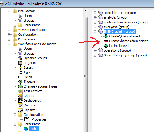

I have a set of queries that are Admin queries and a shared to only two groups. One of them is NOT the everyone group. Why then when I login on as a user not in either of those groups am I still able to see these queries? On page 158 of the 2009 Integrity User Guide it says:

    I discovered the issue. Under "Workflows and Documents" > "Permissions" > "Global" I had a group with the "CreateSharedAdmin" set to allowed. Once I changed it to deny the shared queries in question were no longer visible.

    Hi Dan,
    I'm glad that worked out. I think you might want to just unset that ACL, though: If you have a user who is a member of that group and a member of a group which does have CreateSharedAdmin allowed, they won't be able to create Admin objects unless they're granted CreateSharedAdmin at the user level, because in a conflict at the same level between allowed and denied, denied wins.
    -Kael
