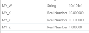

I'm using creo 9.0.8.0 and need a formula to calculate the Blank weight.
Usually we write the dimensions down in a parameter like this 10x101x1. I did change it to 6 separate Parameters so that i have 3 for the number and 3 for the decimal places . I multiply the normal numbers in a relation to get the weight and merge the parameters to a single Parameter for the bom.
now the problem:
some of my colleges say its to complicated and time consuming to fill in those measurements and i need a simplier way of doing it. My new way to do it is by extracting the measurements from a single parameter.
The Problem with this solution is that creo cant calculate it that way because it says theyre all Strings and not integers.
Any ideas how to calculate it? Or make it easier?
PRO_MP_MASS is showing the current weight and not the blank one. And getting the numbers from the first profile isnt an option.
If you want i can provide you the current relation/params/part.
thanks in adavance

Thanks for you answer, but thats the current solution that my coworkers dont like. i need it the other way around.
A problem we have with itos that the decimal is rounded down and up, what isnt a reliable solution for us.
Also we sometimes write mesurements like 10x101.00x20 so that the production sees withe the .00 that the block has to be grinded, what we do not have with itos.

in this case the only solution is additional application "attached" to Creo.
  • Creo Toolkit
  • Creo J-Link
  • AutoIT

if there would be a strtoi (String to Integer) function in creo it would be quite easy, i got the extraction so far with this:
if Search(ABMESSUNG, "x")!=0
GEWICHT=extract(ABMESSUNG,1,Search(ABMESSUNG, "x")-1)+"*"+extract(ABMESSUNG,Search(ABMESSUNG, "x")+1,String_length(ABMESSUNG)-Search(ABMESSUNG, "x"))
if Search(GEWICHT, "x")!=0
GEWICHT=extract(GEWICHT,1,Search(GEWICHT, "x")-1)+"*"+extract(GEWICHT,Search(GEWICHT, "x")+1,String_length(GEWICHT)-Search(GEWICHT, "x"))
endif
endif
endif
Maybe someone here knows how to execute the builded calculation multiplied with the density,
But i guess without a strtoi function its not possible to make it easily in relations.
