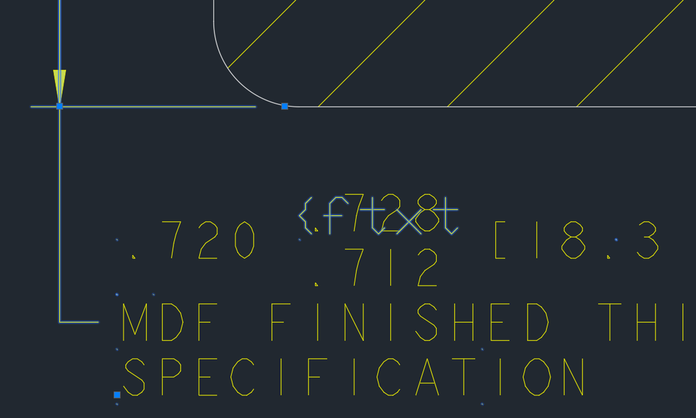

When exporting a Creo 8 drawing to DXF format, the DXF preview shows random text superimposed over dimension text.  This extra text carries over to the DXF file.  Attached is a screenshot of the DXF file in AutoCAD 2022.  {ftxt is not supposed to be there.  Is this a bug with Creo 8 or is there a way to fix this?
Dimension Text:
.720 {1:@+.728@#}{2:@-.712@#}{3:@- @#}[18.3 {5:@+18.5@#}{6:@-18.1@#}{7:@- @#}]
MDF FINISHED@O THICKNESS
SPECIFICATION

please create test drawing allowing the problem to be repeated. Pack the drawing into zip file and upload this zip files. This enable other users to investigate your problem.
