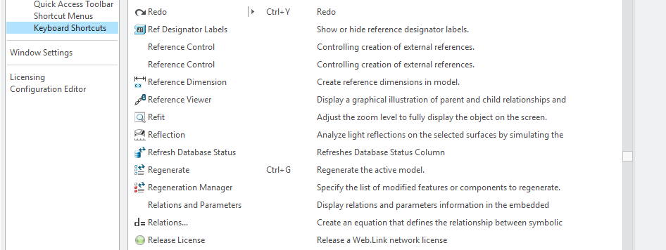

The "Keyboard Shortcuts" have been checked:

Currently it is mostly out of habit (and muscle memory) that I hit "Ctrl-G" before hitting "Ctrl-S" or before going into a family table to verify instances. But now I have to "click" with the mouse instead.

Try starting Creo without config pro/ui to check if that is due to some changes in these files.
In assembly try CTRl+G and check if there is message about regeneration in message area..
Which config.pro is the the "config.pro/ui"?
The file I get is:  creo_parametric_customization.ui
@Dale_Rosema
I mean, configs i.e. Config.pro and creo_parametric_customization.ui
1.] set config.pro option enable_auto_regen  no
2.] modify part dimension
3.] press CTRL+G ... Creo 4.0 M060 regenerates model

That setting doesn't seem to be helpful from the description:
"Features | enable_auto_regen | Enable Auto Regeneration for Unified Edit Mode. | yes, no yes
I did find this and set it to yes, and we'll see how that works out:
regen_solid_before_save yes
"Without category | regen_solid_before_save |
Controls whether to regenerate top model, or prompt
user before regeneration if it is required | yes, no, prompt, force | prompt
Dale_Rosema
(To:MartinHanak)
It was not in my config.pro setting, but I found it. Changed it. And now the "Ctrl-G" works again in parts. My curiosity what was done to change the behavior in the first place? ....  no recent upgrades, downloads, and the date on my config.pro file before re-saving it was from November 2018.

It's not a hidden option as it's in the PDF I have of the options.  Mine's set to the default of "yes".  Unless you specifically changed it, it should be set to "yes" as well.  That other option I found might be better, haven't tested it fully yet.
Just changed the "enable_auto_regen" back to "yes". Rebooted Creo and now "Ctrl-G" works for both .prt and .asm files.
