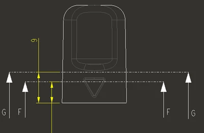

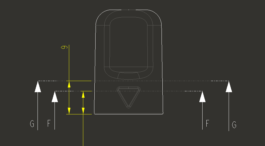

Section cutting plane lines have varying thickness when rendered. Has anyone seen this before or know the possible cause of this? The line font appears to be hidden font in some areas and visible in others.
This drawing template is out of the EU, is this the correct render for cut lines under an ISO dwg standard?

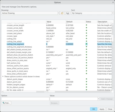

The drawing setup file is coming from a client with their format. They intend to use ISO dwg standards in the setup file, but this has nothing to do with the root cause. I will have to try and find a reference documenting how this should be set for ISO drawing standards.
The cause is a detail option; by changing to the default value of 0 it renders as expected.

Have you tried this out of the box, without any configurations? Just to rule out something in your setup.
tbraxton
(To:StephenW)
