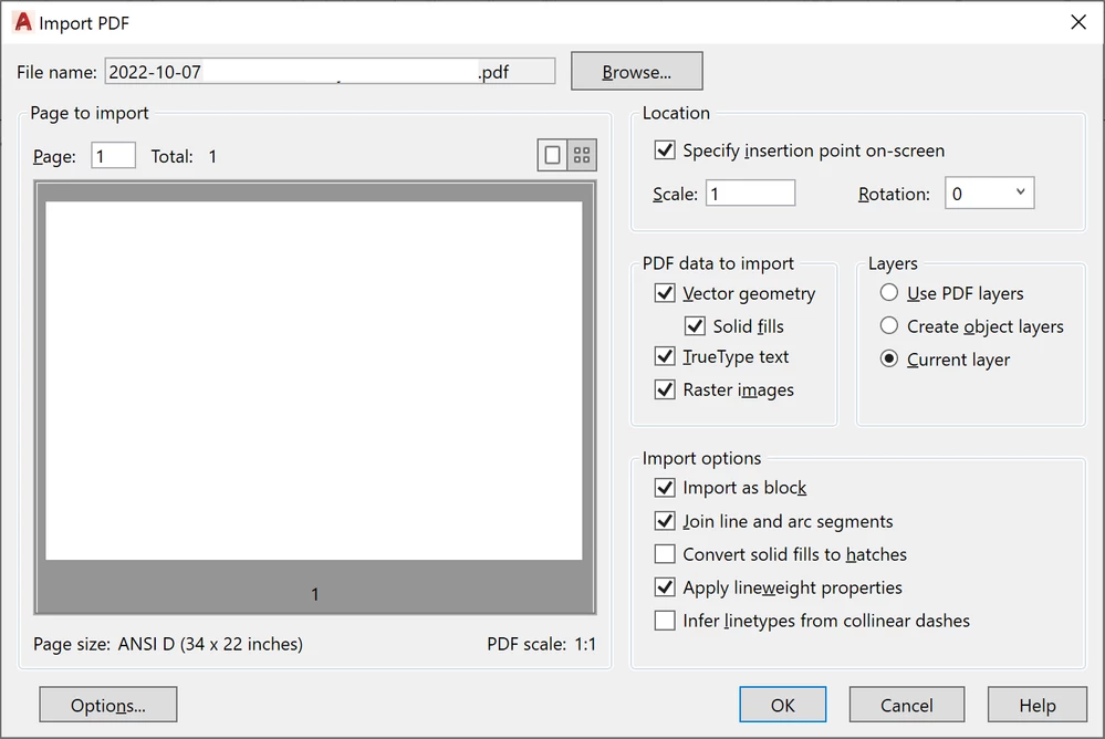

So, what I've been doing a lot of lately is marking up drawings of the people that I supervise for Promotion Requests in Windchill.  I tried using Adobe Pro, but, honestly, it sucks.  REALLY sucks.  TOTAL PITA to work with.  I hate Adobe in general and trying to draw GD&T symbols and geometry is miserable and time-wasting.  Then I had a brainstorm:  AutoCAD.  In AutoCAD I made a .dwt template that has a BLOCK (black) layer, and a MARKUP-RED and MARKUP-YELLOW layer, where the BLOCK layer is the current layer for when I import the PDF.  I import the PDF generated from Windchill as a block (so I can't accidentally change it) making sure to have the "Raster images" checkbox marked too:

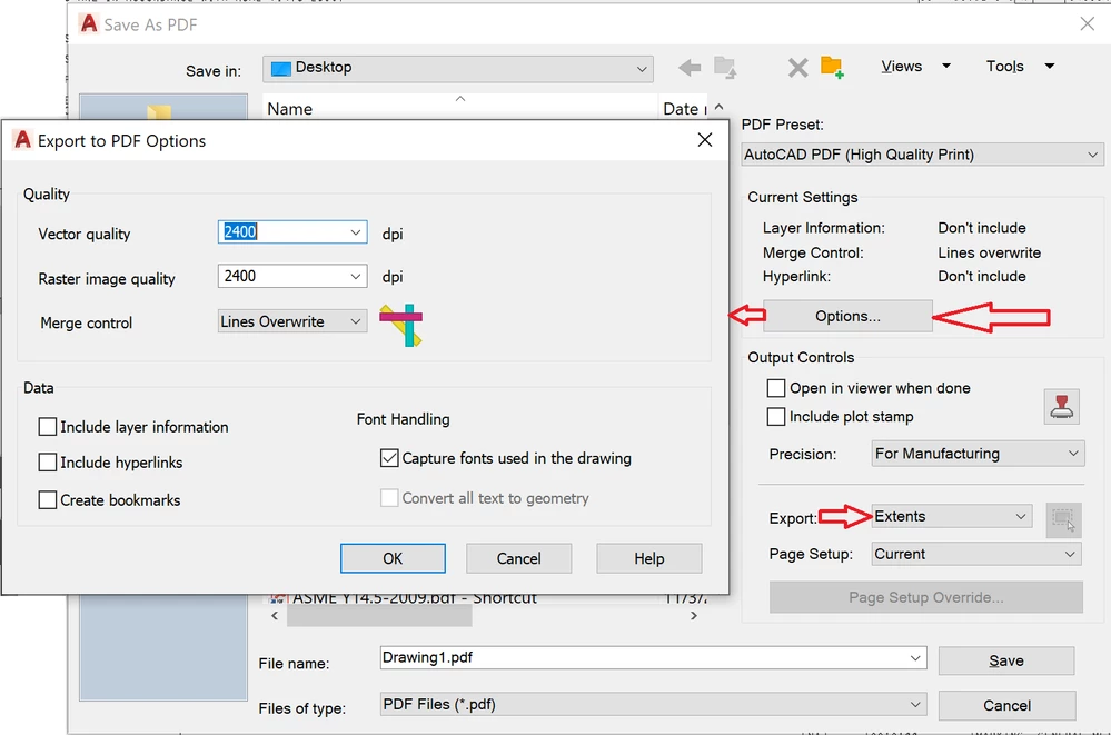

Then I switch to the MARKUP-RED layer for corrections, and use the MARKUP-YELLOW layer for "ok".  You can create shapes (rectangles etc.) to use for yellow cross hatching, then freeze the BLOCK layer (so it doesn't get confused with the block geometry when trying to hatch the shapes), then thaw the BLOCK layer when you're done.  Then when I'm done I export it with the following settings:
The "Options" as marked by the arrows are important because that determines the quality of your output, and the "Extents" means everything inside the outer border of your format gets output, unless you have stuff floating out in space.  If you don't do that the PDF decides randomly what your size is with no consistency.  For multi-sheet dwgs, maybe there's an easy way to do it but I'm trying to re-learn AutoCAD after not using it for 20+ years so...  I bring them in one sheet at a time as a block, output each page as a separate PDF, then merge them all together in Adobe as a single PDF after all the sheets are done.  If I figure out a better way I'll post up.
