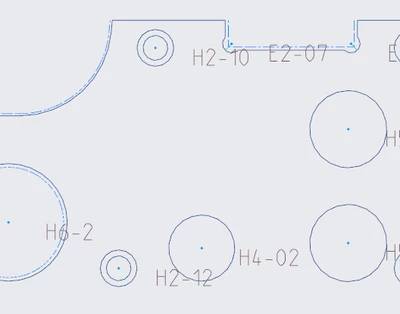

Is there a way to show the names of user selected datum points in drawing views?

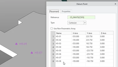

Point Names coming from point cloud as these:

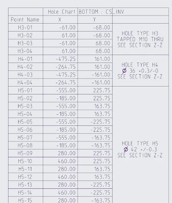

Can be listed in hole table like this:
but should as well showing up on a drawing view unlike this, because here I cannot specify the location by my self and I can not deselect unused points.
and I do not like to activate the option, becaus this is a user setting and the names need to be on the drawing all the times.
Does any body know a way to do it in a way that the names in the point cloud is linked to the name on the drawing view?

Note that these tags can be collected on a layer:
Then the visibility of that layer can be controlled on the drawing views, etc.
However, I don't know of a way to define position of these tags on the drawing...
