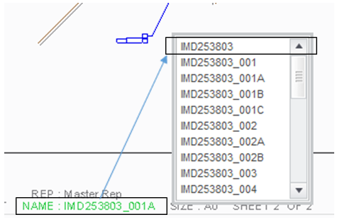

Here in below snap - After merge I want to replace model "Name" in sheet which is in Green Color (D2_Drawing) with D1_Drawing.
Please do the needful.

Your new code does not include a call to ProDrawingSolidReplace on drawing D2, which should be done after ProMdlRetrieve and before ProDrawingMerge.
Hi Matthew,
I have tried your options but still problem is pending...It is not update...
