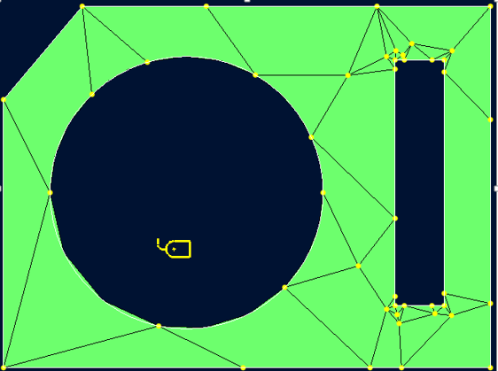

Looking for some advice or clarification that I understand how Mechanica works with respect to meshing.I have created a simple test part shown below and gone through many of the mesh settings to understand the influence they have. Note I am using Wildfire 4.0.
My question is, is the default mesh shown below on the top sufficient?
I understand Mechanica uses the p-element method which means a mesh can be coarse and results are obtained by increasing the order of equations until convergence is achieved, so I think this mesh is OK?

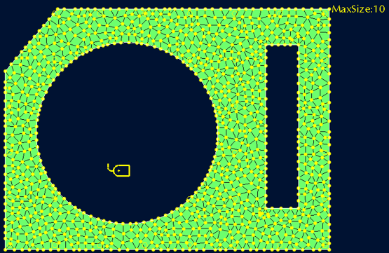

I am working with some people who used to different programs and they desire that I create a more uniform mesh - kind of like I have created in the bottom picture by limiting the max element size. But is this approach good practice with mechanica? I guess it would significantly increase the analysis time?
If anyone can give some advice and let me know if I am understanding this correctly it would be much appreciated.

The best way to answer your question "is it sufficient" is to run an analysis using Multi-Pass Adaptive, and look at the convergence graph. If it levels off smoothly before reaching 9th order, the mesh is sufficient; if it's still climbing (or oscillating) then a finer mesh is needed.
Using a maximum element size as you've shown is rather a blunt tool. I much prefer to use Edge Length by Curvature (which can be applied to the whole part, or to selected geometry) which varies the size in proportion to the geometry radius. The default value of 2 is pretty good; 1.5 or 1.0 is usually overkill. This produces a more efficient mesh, with smaller elements only where they're needed.
In general, Mechanica is pretty fast to run so I tend to use SPA but make the mesh better than I think is necessary - so an ELC of 1.5 or lower in the areas I'm concerned about, or globally if it's a simple model.
If your H-element colleagues complain about the rapid mesh transitions Mechanica can use, just tell them that you'll use small elements everywhere if they'll run their models using 9th-order elements!
HTH!
It looks like your model is not that big, so run an analysis for each mesh, and compare the results. Then show the results to your colleagues. And post a copy here

For modal analysis the mesh size is much less of an issue than for stress analysis. Basically you only need to get the stiffness and mass distribution right, so for most parts (in H-elements) any 2nd order mesh will do.
I suspect you will see larger differences in stress analysis (if you will be doing any?)
As Jonathand mentioned, run a MPA-analysis, create measures of the quantities you are interested in, and see how those converges as the P-level is increased. If a mesh is "sufficiently dense" is difficult to say; every model is unique. Beware of singularities; you have some sharp reentrant corners in your model that may not converge.
The default mesh settings are, so I've heard, is a compromise between solution acccuracy, meshing time, and solution time. My experience is that for geometries that are very simple, like a square, or a square block, the mesh becomes too coarse. If the geometry is more complex, then the mesh becomes finer automatically.
/Mats L/
In that case also demand of your colleagues that they do the same, so decrease mesh size and compare results for each mesh size. If the results no longer change it shows that the mesh size is okay. (This is what all the text books say one should do, but in practice I've rarely seen this done).
