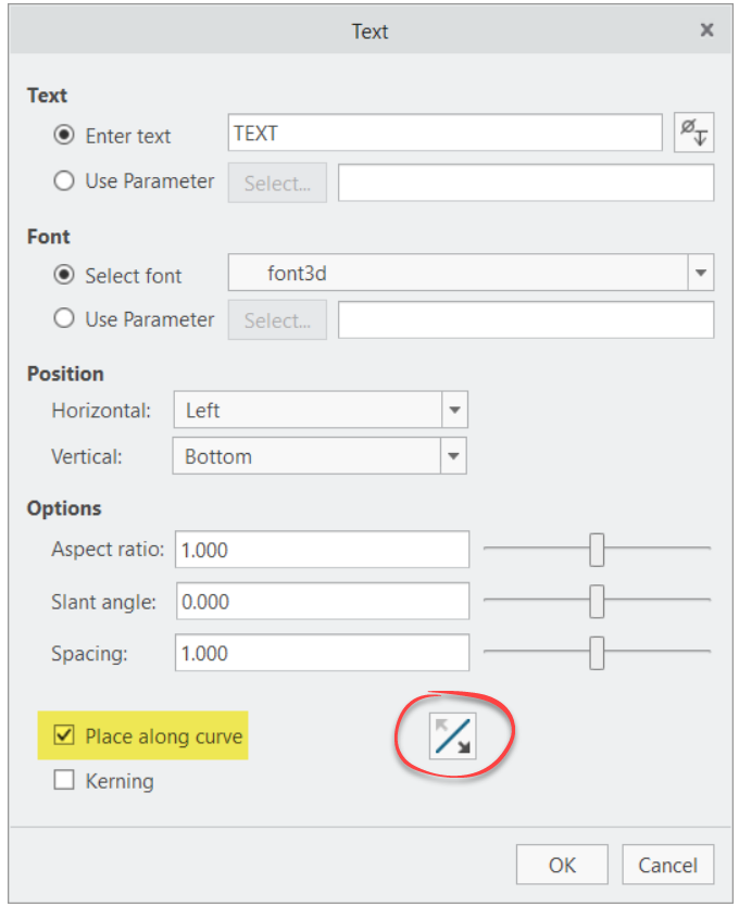

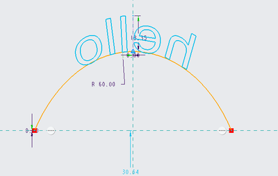

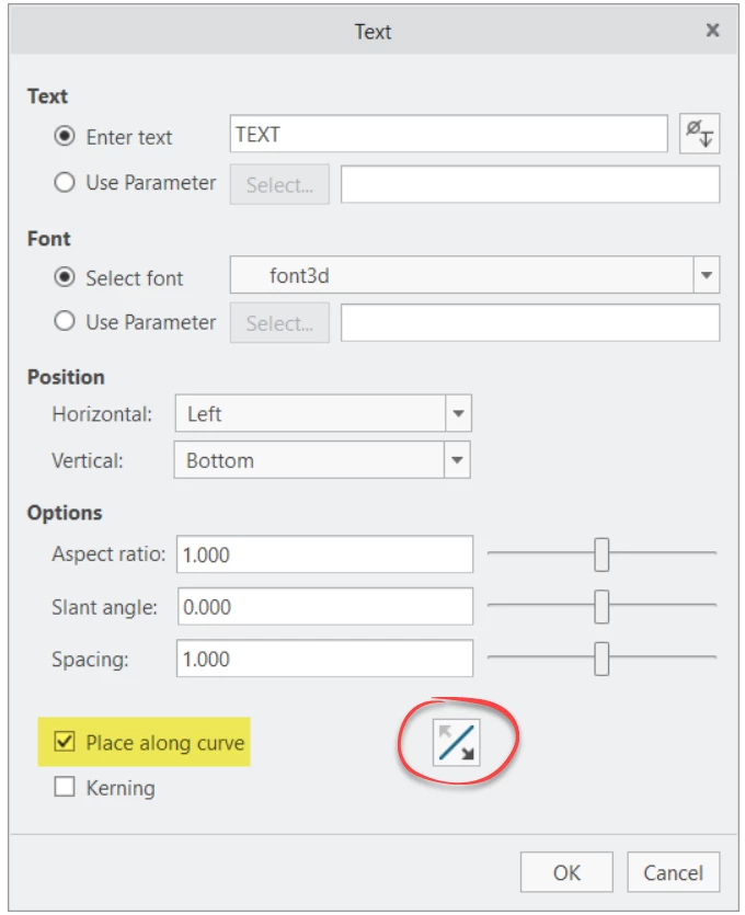

Please teach how to set creo 'text' option
Inho-_-
I want to reverse the text left and right
How do I do that ???

If you have placed the text along a curve then try flipping the direction in the UI circled in red.
