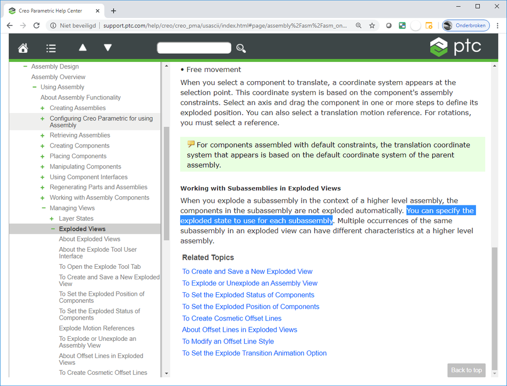

I am trying to reuse the explode states I defined in my sub assemblies when exploding the top level assy.  I thought there was a way to do so, but I can't remember how or I'm mistaken.  I may be thinking of style states.  A year away from Creo has taken its toll on my memory of some functions.

Looking at the Creo Help file, one would think this should be possible...
Sadly, I have no clue where you can "specify the exploded state to use"... 😭
There seems to be a workaround by using the Default Explode view of the assemblies
