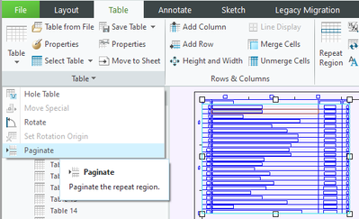

Hello ptc community,
If I create a List of materials (BOM) of an large assembly, the list does overlap with the frame of the drawing.
Is it possible to split the list from one to two, to shorten the length?
I know that I could use a bigger format for example to change from an A3 sheet to A2.
But if everything fits to the format sheet (If the list is split to two) it would be worse to take a bigger sheet.
Version of creo is 4.0
Yours sincerely,
Alexander

There is an option in the repeat region menu to paginate the BOM into multiple columns. You can then move a portion of the BOM to a different sheet.

You mean in the menu manager right?
Which one is it.
kdirth
(To:Alex_R730)
Creo 7:

Thank you, in time i try that out.
