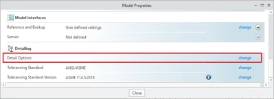

You simply may be looking in the wrong place. Show_clipped_annotations is a model detail option, not Creo configuration (config.pro) option. When you open the model, go to File > Prepare > Model Properties and click change for Detail Options (at the very end of the properties window). There you'll find show_clipped_annotation option.
Thank you so much, LukMazur!
