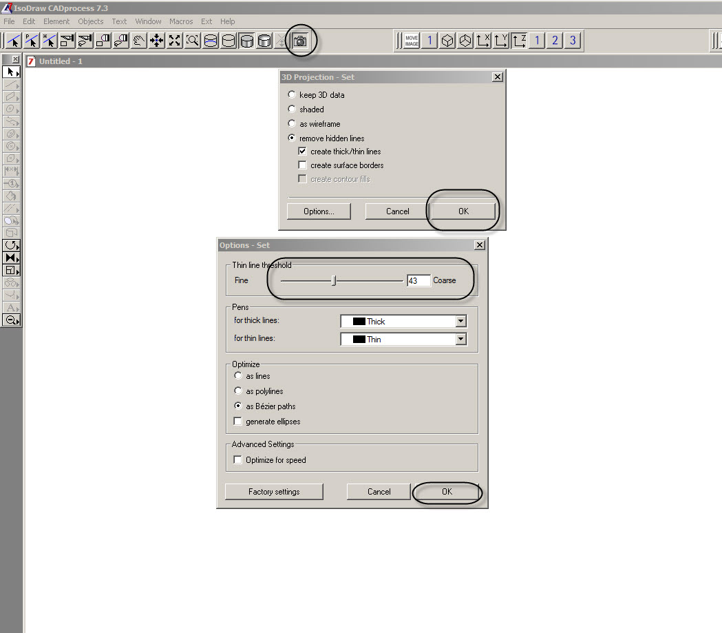

Hey guys, played around with isodraw on and off for awhile. I can't find the answer in the documentation, but it should be a relatively simple answer. How do i get images to go inside the grid box? I open pvz and other cad types, and they always bigger than and far away from the grid. All the instructions show them as already being inside.

Your image is in the 3D enviroment, if you click on the camera, then click ok your image will be converted to 2D. If you need more or less detail click on options and move the slider accordingly, the smaller the number the more lines will show up. Once you have done this highlight your image by clicking on one of the lines, four red squares should show up around your image. Then you can follow the above instructions from Vladimir N.

Do you mean "Fit elements" option (in main menu select "Edit" -> "Move" -> "Fit elements")?
I don't think so. Whether highlighted or not, Fit elements is grayed out for me. I'm referring to this.How do I get inside the box, and control the measurements of the box...

Thank you sir! I knew it was something simple and easy. Isodraw training just doesn't get around to mentioning it.
