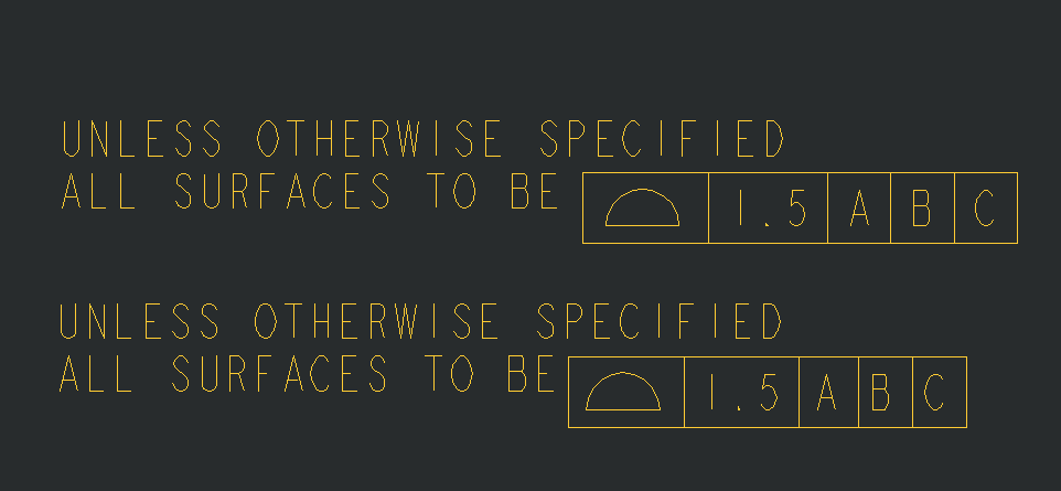

In this first line is created by using the Custom symbol method and second
one is as free note. in G-Tol I face the spacing problem (Refer the Pic)
If any one knows how to solve this issue, help me

I was able to repeat what I think Mohan did and got the same results:
I the image, the top frame was created by using the @[ and @] in the note.  The lower frame was built using the annotation Geometric Tolerance button.
The problem is that a frame created by using the @[ and @] in the note have a different spacing on the boxes than a frame created from the button on the toolbar and placed as a free note in the drawing.  If you look at the image above, every block is just a little bit more narrow in the second (button generated) frame than the note built one.
The differences occur at various points:
1. In the symbol block, the extra width occurs after the symbol
2. in all other blocks, the extra width occurs prior to the text
@Mohan: I tried messing around with the fonts (changed font, size, text alignment) to see if it was an alignment issue, but I could not find anything that would change the spacing.  It looks like Creo defaults all spacing in the custom note version to be centered with equal space before and after, while the guided button generated process left-aligns the symbol and right-aligns the text (if you look, you can see the spacing on the left and right of each box is different).

If these the workflows you're using as well (gtol vs. note with boxed text), then yes, I can confirm that a note with boxed text can look functionally like a feature control frame, but not identical.  I'm not sure what the end goal is for you, but this may be helpful:
For the exact spacing between text as seen in the gtol, you can put the text together separated by the narrow space which is '|' in the special character set:  (^A / ^B donate entering/exiting special character set)
^Aj|^B.001^A|^BA^A|^BB^A|^BC
This will not, however, include the box lines, which are calculated for gtol display by looking for the ^A|^B character in the final text.  So if you were, say, making a custom symbol that was a fake gtol, you'd need to add the lines.

Possibly look at the width factor on the text style. I was able to vary the free note by varying the text width factor.
