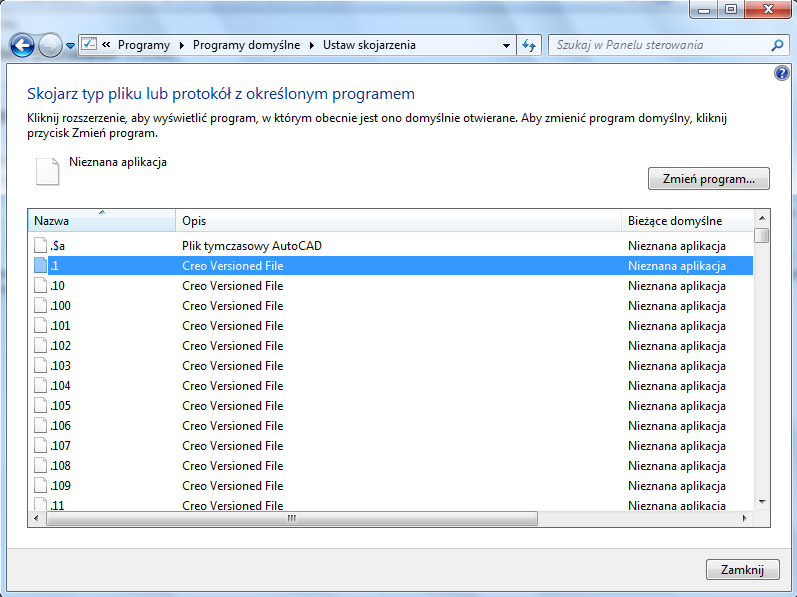

I have a problem with odd extensions from Creo 2.0. It made them automaticly. I hadn't perceived it before. However I created video file - the name of it was the date "11.03.14". System considered ".14" as extension of file. How to turn these extensions off?

Welcome to the forum. Creo/WF have always created the .1, .12, .100 extensions to the parts and assemblies everytime you save them. They are called versions. They index everytime you save a part/assembly. You may have had them hidden before, but they have been there.
The usefull thing about them is that if you have been working on a part and something didn't work out, you can go back to an ealier version.
They do tend to take up space, hence you see the discussions about purge them periodically.

Thank you for your answer. Of course I knew that Creo saves everytime in new file. I didn't know it creates such files. I found soultion for my destination. Just changed file name for "11.03.14.mp4" and it`s ok now.

There are two ways, but similar result.
In one, you select the file and choose "Open With..." and pick the application you want and check the box "Always open with..." or whatever.
In the other you hunt down the association in the Registry and remove it.
The downside is that double clicking the file won't open Pro/E Creo whatever, based on the extension, but since I never do that, it's not a loss.
PTC stakes out .1 to .400 or so. Correction - from .1 to .999, in WF5.
Ahh, actually, the ".1, .12, .100" are actually the Iterations if I'm not mistaken. These are created every time you save. You see these when you are not using a PDM system and instead saving it to a hard drive. Like in Windchill, "Version" A.12 is the Revision "A" plus the iteration ".12". Normally Pro/E will always open the last iteration. You can easily go back by deleting the iterations you don't want. Like a poor man's version of "frames".
