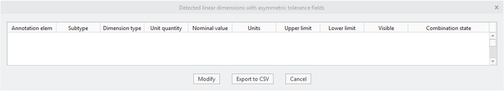

Hi all,
I have created a list in a dialog window using the following code (Creo 5.0.5.0)
ProUIDialogListAdd(DIALOG_DIM_LIST, DIM_LIST_NAME, &grid_opts);
ProUIListListtypeSet(DIALOG_DIM_LIST, DIM_LIST_NAME, PROUILISTTYPE_TABULATED);
ProUIListColumnsSet(DIALOG_DIM_LIST, DIM_LIST_NAME, 10);
ProUIListNamesSet(DIALOG_DIM_LIST, DIM_LIST_NAME, 10, szListClmnNames);
ProUIListColumnlabelSet(DIALOG_DIM_LIST,
DIM_LIST_NAME,
ProStringToWstring(wcText, "Annotation elem\tSubtype\tDimension type\tUnit quantity\t"
"Nominal value\tUnits\tUpper limit\tLower limit\tVisible\t"
"Combination state"));
ProUITableAlignmentSet(DIALOG_DIM_LIST, DIM_LIST_NAME, PROUIALIGNMENT_CENTER);
This gives the following result
How can I now add items to this list?
I have tried to do this using ProUITable functions as that worked to set the alignment but this failed.
I have tried to do it with ProUIListLabelsSet but this failed also.
Can anyone point me into the right direction?

I was able to solve my problem. Once I figured out the API needed was called ProUIListLabelsSet I found the following post
https://community.ptc.com/t5/Customization/How-to-add-and-remove-objects-from-the-list/m-p/592659#M8117%3F&art_lang=en&posno=2&q=ProUIListLabelsSet&source=search
This helped to accomplish what I wanted to do.
