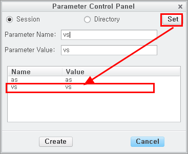

I want to take input and add it to the List.
Like this!
However, the triple and double pointers described in the API are hard to understand
If you know how to take text and add it to the list, please help me
thanks

CHASEONHO18-OpalAuthor
18-Opal
May 29, 2018 8:55 AM UTC
The problem between double pointers and triple pointers has been resolved.
I can now add the list.
We are currently working on implementing the removal.
If anyone is facing the same problem as me, please mail me
We will provide sample code and a dialog resource file.
