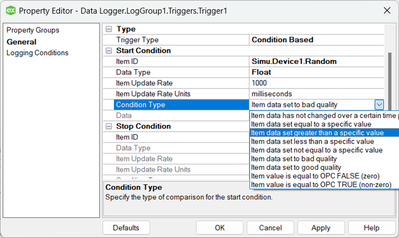

Greetings,
You can set the triggered conditions as triggered-based and then set the condition type according to the data type. If the item ID has the data type Boolean, you can set it as OPC False or OPC True, but if you do have any other data type, you can set the condition as greater than or less than a specific value
if you need any more help related to this you can submit a ticket and share the Case no. we can connect to dig more into this.
