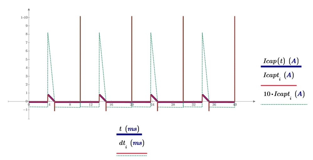

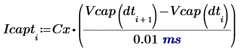

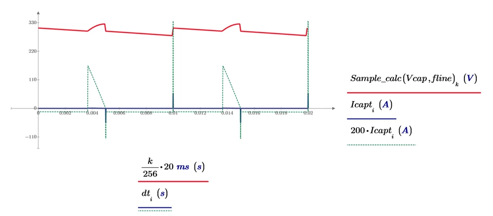

I have attached a sheet with a simple example function where the voltage jumps. This causes convergence problems.
I am working actually more complex signal at a capacitor, but I cant share my actual sheet.
Basically my attached example is the same... I have waveform with a discontinuity.
Later I do a derivation of the voltage signal.
Also I want to do a FFT of this signal and therefore I sample it.
In any way I have convergence problems and I dont know how to handle that. Do you have an idea?

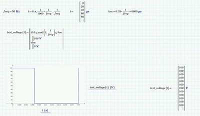

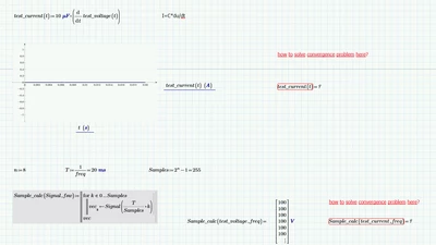

I changed to voltage function in the new sheet, have a look. This is more realistical to my actual convergence problem than the previous sheet.
January 27, 2023
How about defining Icap(t) using a "try ... on error ...." construct.?
The "try" case would contain the original definition of Icap and the "on error" case a meaningful value or rather a NaN.
