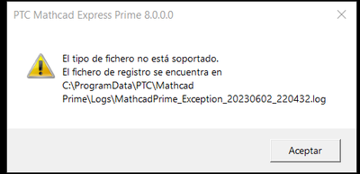

I am having trouble opening a PTC Mathcad file. The following message appears. Is there any way to solve this situation? Thank you so much.

It looks like you are trying to open a Prime 9 file with Prime 8. This can't work as PTC has decided for incompatibility between all versions even though the file extension remains the same. While Prime 9 can open a Prime 8 file, it cannot save a file in Prime 8 format like other software is able to do (losing just the features not available in the older version) and your P8 refuses to open a file created with a newer version.

Tengo instalada la versión PTC Mathcad Prime 8.0. No debería ser un archivo Prime 9.0 ya que siempre trabaje con la versión P8. Igualmente subo el archivo para ver si tiene algún otro error.

I see!
Its not a P9 file but its "simply" damaged.
This seems to happen quite often with Prime and Prime does not provide any means like automatic backups or a meaningful error message  as former versions did, which would help to repair the file.
Hope you made manually backups yourself!
I tried to repair the file but with no success.
You may contact PTC support - at least they should know how to save as much from the damaged file as possible (yes, contrary to my experience, I keep thinking positively)
EDIT: Find attached my best try to repair the file. All the pics are missing. Some pics could be saved - i attach them in the PICS.zip archive.
