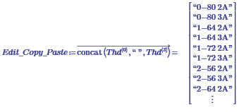

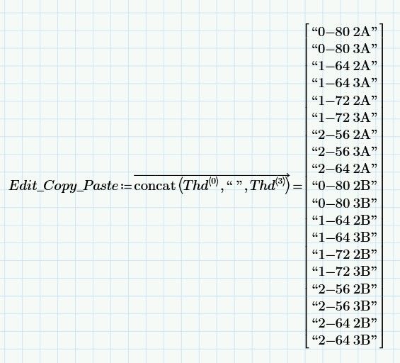

Hi
Have created one matrix with the data
Created a column vector called Edit_Copy_Paste that concatenates two columns.
Used Copy and paste to get this column into the editbox in one copy and paste operation that includes full column.
Cheers
Terry

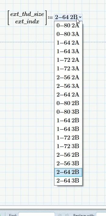

Make ComboBox's right side data from EXCEL data. It includes data name and line number of each data as shown in red ECP matrix. Then you can copy and paste it to the ComboBox data.
Then  select the data line number by ComboBox and you can get the line of the data.
