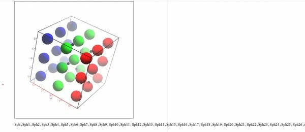

I am trying to represent on a 3D plot, spheres placed neatly one with respect to the other, as seen in the following picture.
The problem arises when the argument of the plot consists of countless elementary functions.
Is there a synthetic way to represent multiple functions so you do not have to write an endless list in the plot argument as shown below?
Thank you very much
Franc

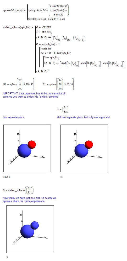

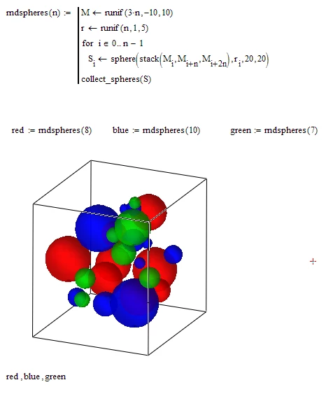

I gave it a try in Mathcad and was surprised that it worked:
Now you would only use just one plot argument for each color:
Something like the attached? ("countless" would be an exaggeration though!):

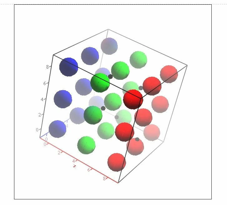

Hi Alan,
Without editing the program, but simply by modifying some 3D graphic properties (eg perspective and enabling fog) the graph becomes unacceptable as you can see below:
You won't be happy with my "solution", too.
After saving and reopening the worksheet I see this
and this
I had not changed anything in the sheet - not sure whats going on. By this I mean I don't understand why it worked in the first place. I would have expected what I see now as all the combined spheres are represented but just one contiguous data mesh - they have to be konnected. But I wrote already in my answer before that I was surprised that it worked - obvioiusly for good reason.
Adding a row of NaN*s between the data of the single speheres did not help as the 3Dplot component would refuse plotting with the usual "non-scalar value" error.

It is all OK! Look :
Yes, thats what I understood from your first post. But if you do just this change, we don'tr get spheres anymore

@F.M. wrote:
Hi Alan,
Yes. You have to choose the properties carefully to get the desired look. All the spheres are really just part of a large single matrix and hence are actually interconnected. M15 doesn't allow for NaNs to be used in 3D plots to allow for disconnects between the spheres.
Alan
