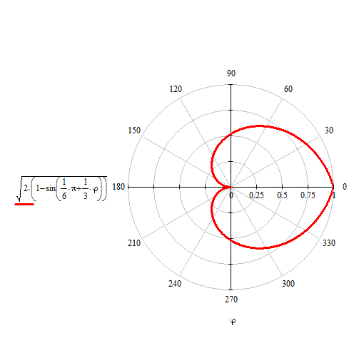

I'm new to polar coordinate :
From :
To :
How to rotate the red shape in polar coordinate 90 degree clockwise ?
Thanks in advance.

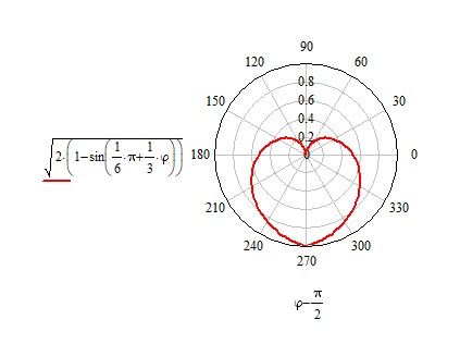

Hi
Just subtract 90 degrees from the angular value.

Thanks, Terry, I'm so embarrassed...It's so simple : ( I guess polar coordinate that's very helpful for rotating... )
