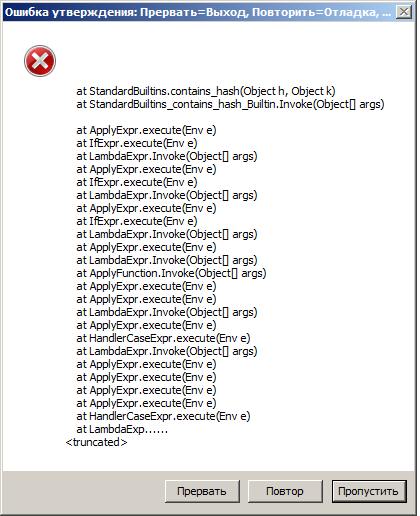

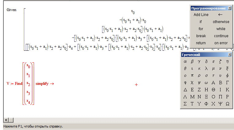

Some time ago, there was a problem with the use of "Given-Find" solve block (I can not find this theme in forum). In an attachment, you can find a document with a solution to this problem from the PTC's technical support.

1) This "solution" was already posted by MihaiMoraru and me just a few hours after the question was posed in July 2013 in that very thread you mentioned. So I am confused how it comes that it took PTC tech support more than a year just to come up with that very same "solution" and post it to you. I guess you opened a support call at that time?
Here is the thread: http://communities.ptc.com/message/210427#210427
2) This is no solution at all, its just a (depending on the circumstances) very cumbersome workaround. Mathcad's symbolics really should deal better with vector elements and should in any case not throw that confusing and misleading error (which it still does so its still a bug).
