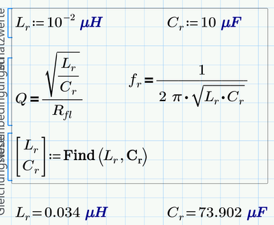

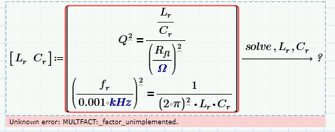

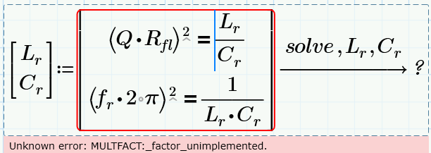

So I'm struggling to understand exactly what is the issue that is occurring that is stopping the system of equations below from solving. I know that it is solvable, I did it by hand, and I have the answers for verification. However, it is in the software claiming to be unsolvable. Am I entering it in improperly?

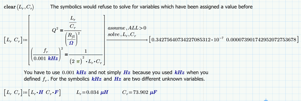

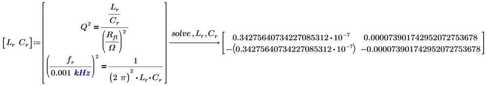

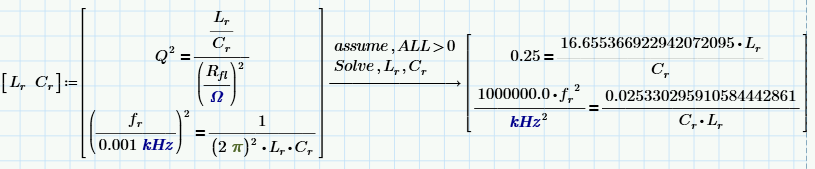

OK, I played around with this puzzle:
The solve block fails when using square roots and variables with units
Getting rid of the roots does not help
Getting rid of the units does not help, either
BUT .... getting rid of roots AND units does the trick
Because we squared we get also negative solutions which we can get rid of by using the modifier "Assume, ALL>0"
Of course we must add the correct units manually

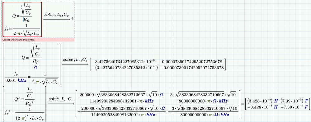

I was curious and tried the old symbolic engine (muPad) which was included up to version Prime 6. Not surprisingly its a bit more capable than the new one. It still throws a strange error initially ("Cannot understand the syntax") but we get results by either removing the units OR removing the roots:

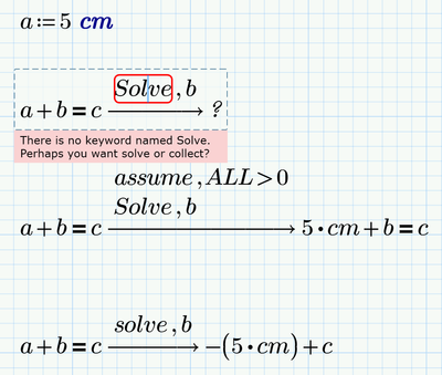

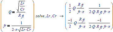

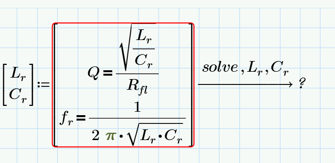

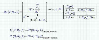

This should not be a problem. Mathcad 11 gives:
With Prime you might try:
Apparently Prime doesn't like roots (it's not a rabbit).

Thanks, this got rid of the Error! Problem is, a new one popped up, and I have no idea what it is (I cannot find anything about it online). Any ideas?

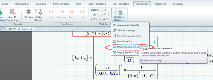

October 20, 2022

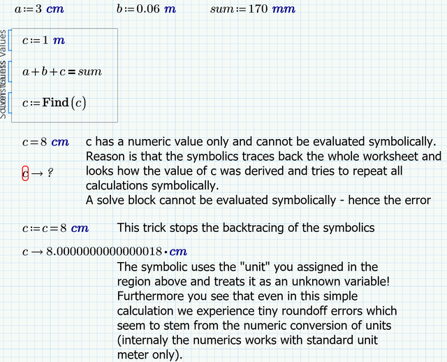

My guess is that Prime's Symbolic is also unable to cope with the units assigned as it does not know anything about units. If you want to use the symbolic "solve", then better without numeric values at all, as shown by Luc.
But in the concrete case no symbolic solution is needed at all. A numeric solution block will do as well:
October 20, 2022
Prime may be confused by your subscripts, thinks they're a vector index.  I got the same thing.
Without subscripts there's no problem:

That wasn't the problem of the OP. This is:
