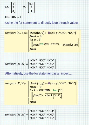

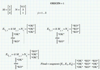

Hello everyone,
I am quite new at programming in Mathcad.
I am trying to create a matrix using different vectors that are obtained based on a certain condition:
I made an example with vectors N and M. The idea is to reach at the end the matrix "Final".
Is there a way to use a for loop function to define the final matrix taking into account that the number of rows in the vectors N and M can change (but still equal)?
Thank you,

Perhaps something like this?
Stuart

Thank you for your help StuartBruff.
It worked perfectly.
SG_10318843 I checked that thread before, but not entirely clear.
Either way thank you for the reply.
No worries.   Here's a programming-free alternative that should work in Mathcad Express.   It replicates the vectors and then applies the check function with vectorization.
Stuart
This should be Express worthy.
