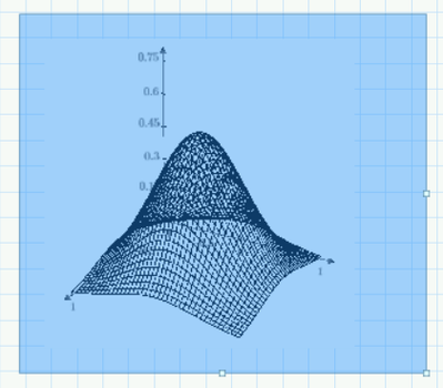

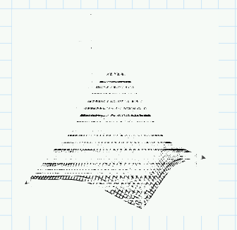

My 3D plots have started appearing like this:
When I drag the plot area, the problem disappears:
But as soon as I let it go, the weird pattern reappears.
I thought it might be a problem with the mesh frequency pairing with the pixel spacing on my display, but resizing does nothing, and, in fact, the problem appears as soon as I open a new 3D plot area.
Anyone encountered this?  More pertinent question: does anyone have a solution?
Working in Prime 8.0.0.0
Thanks for any hints.
Richard

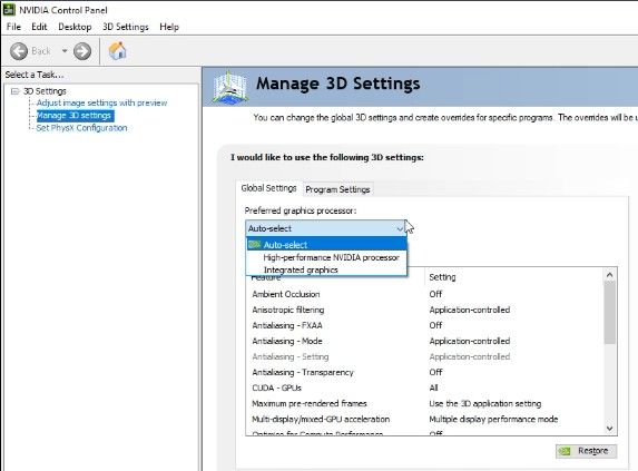

First time select the NVideo control panel
In this control panel on the left is 3D settings.
In the Manage 3D Settings do three things
Set the preferred graphics processor to "auto select"
Press the restore button in lower right hand corner.
Press the restore defaults menu item in top right corner.
Close the window

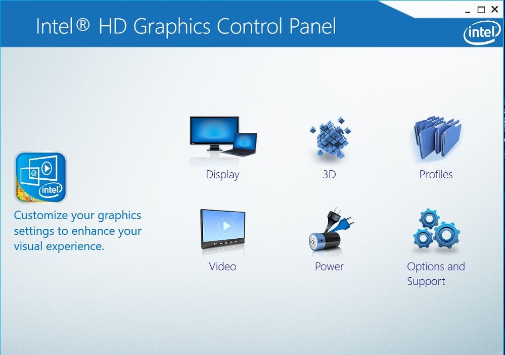

Right click again on display blank area
This time select the item graphics properties

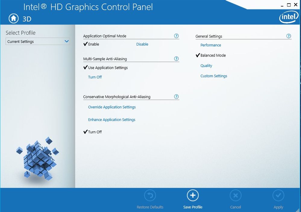

A dialog box for the intel graphics is displayed
Select 3D
A dialog box will open with the 3D settings
In the middle bottom is a restore defaults button use it
In bottom right is an apply button use it.
Close the window.

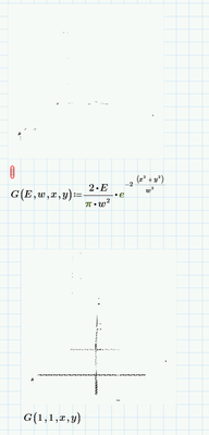

Sure.  But it's as simple as: open a new worksheet; insert 3D plot.  Then plot whatever function you feel like displaying.  You can even skip the "plot whatever function you feel like displaying" and the problem still exists, as you can see in the screenshot below.
Graphics card?  I don't know.  On my device manager I see Intel UHD Graphics and NVIDIA RTX A2000 8GB Laptop GPU.  Does that answer your question?
Must be a video card issue...OR, it's a Prime 8 issue...my screen image here is from Prime 9 - looks normal.

Thanks, Terry.
I have access to the NVIDIA control panel, but it looks as if our IT folks have reserved control of the Intel HD Graphics to themselves--at least, it doesn't appear on my menu, nor does it show up on search.  The NVIDIA changes alone didn't do anything.  You have, however, given me sufficient grounds to get the IT folks involved, so that's what I'll do.
