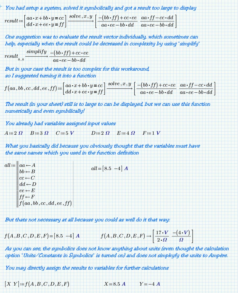

As your sheet is too complex for me to edit and show what I mean, here is a simple worksheet with some thoughts and explanations.

You can turn the result into a function of the unknowns.
Use "result(xIcb0, xbeta,xR1043,.....) := [ ] solve... "
You will still get the message about the expression being too large, but you can use that function an can evaluate it numerically for any value of the unknown variables.

It just meant the vector with the equations followed by the symbolic "solve" - all unchanged as you wrote it in your sheet.
What I wanted to say was that you simply replace the variable result by the function definition result(xIcb0, xbeta,xR1043,.....).

You defined a function which gets you just the first of the twelve values.
I had in mind y function which would return all 12 values at once by putting the function definition in front of the expression above.
You may also notice that the arguments you feed into a function must nOT have the same name which you used when you defined the function. So the local assignments like xR950 <- R950, etc are not necessary. Simply use R950 when you call your function.
Furthermore you used square brackets which defines a matrix. So your result [3.256]mA is a 1x1 matrix which, as I think, you did not intend.

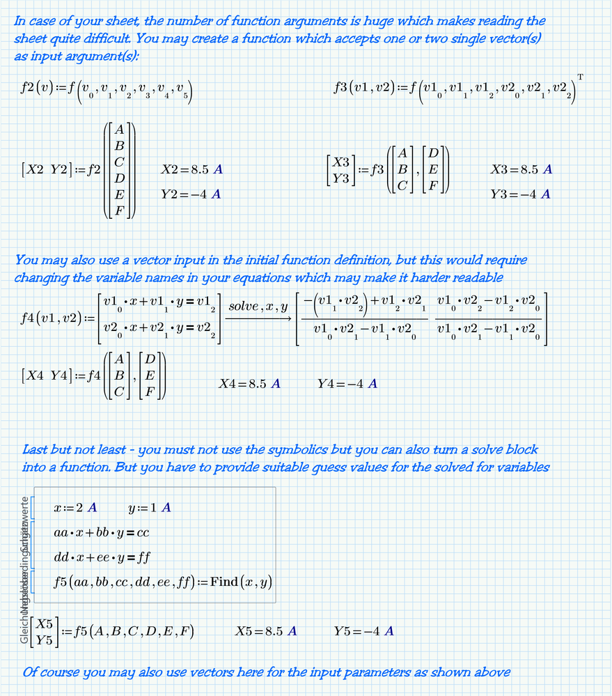

ALL should now be a 12 x 1 row vector with all results.
