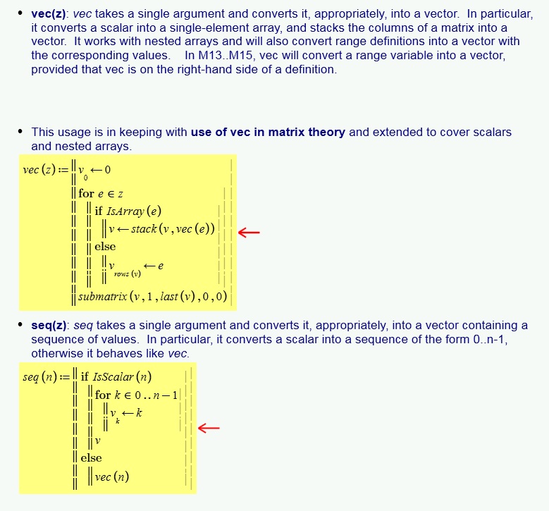

I've only got Prime Express, so can't run your worksheet properly. However, my quick scan through it suggests that the variable "i" may still be a range variable. Change it to a vector by defining a function "vec" that converts range variables to vectors:
vec(rv):=
v <- 0
for i e rv
...v[rows(v) <- i
return v
or, for a more complete version, try the following ... I think it should work in Prime 3.0.
These functions form part of my standard Mathcad 11..15 library. I created the attached Prime file in the Prime 2 beta to check whether they still worked in Prime ... I think it works but I'm not sure.
I do remember that whilst v:=vec(1..10) will work in Mathcad it won't work in Prime ... Prime won't let me enter a range variable as an argument, but I think rv:=1..10, v:=vec(rv) should work.

Type in the code for vec that is show in the image ... or load the "dev - submatrix" file and copy the vec function to the start of a blank worksheet.
Then type
rv:=1..10
IsArray(rv)=
v<T>=
where <T> is the matrix Transpose operator.
You should get what looks like a vector of all zeros for IsArray= - it isn't a vector, it's the result of Mathcad applying IsArray to each value in the range variable rv. You should also an error for v(T)=.
Then type
v:=vec(rv)
IsArray(v)=
v<T>=
and this time you should (hopefully) get the result IsArray = 1 and v=[1 2 3 4 5 6 7 8 9 10]
