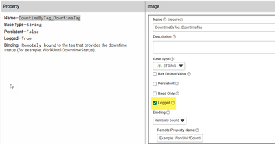

I have configured RTPPM, the downtime status and production and waste counter are the remote properties which is expected from Kepware.
Can we keep those properties as "Binding: None" and update values from service?
How frequently the downtime status and part count (total production, waste count) updated in operator dashboard?

The RTPPM models are processing data from the value_stream. Ensure that the model properties are set Logged-True as referred in the PTC Help Center.
Binding - Remotely is the standard method for receiving data through the Kepware ThingWorx Connector. It is possible to keep the Binding-None or Local depending on the data source.

Yes it's possible to make it work without using Kepware tags. The details depends on what the information source is and may require customization.
If you have other properties that can receive the information, this is the easiest method. Instead of binding a Kepware tag, you can have a property (it can even be on another Thing) that has the information. When setting the tag binding (on ProductRemoteTag for example), instead of using Remotely Bound, you can select Locally Bound instead and point to the Thing & property that contains the value. RTPPM should use this information the same way as if it was from Kepware.

If your source of information is something else in Thingworx that would send values into the equipment (services for example) this is a bit more complicated. In most cases you will need to push a value into the tag property's value and Valuestream. Here is an example of code that does it for ProductRemoteTag (the product) :
var TheValue = ENTER_VALUE_HERE;
var TheDate = new Date(); //you can enter a specific time instead
me.ProductRemoteTag = TheValue;
me.AddStringValueStreamEntry({
timestamp: TheDate,
propertyName: 'ProductRemoteTag',
value: TheValue
These are the properties where normally you would link the tags and must now be targeted by your code :
- Downtime : DowntimeByTag_DowntimeTag (and optionally DowntimeByTag_DowntimeTagHistory)
- Product : ProductRemoteTag
- Joborder : JobOrderRemoteTag
- Production event (batch) : ProductionEventRemoteTag, note that in most cases this is also required to activate the product and joborder changes
- Production event quantity : the property who's name is in ProductionByTagAndTime_AttributeProperties -> TagPropertyName
- Waste event quantity : the property who's name is in WasteByTagAndTime_AttributeProperties -> TagPropertyName
