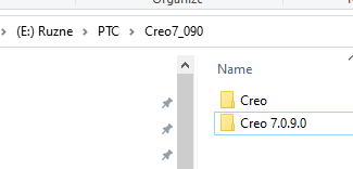

2.] please publish a picture of Creo installation directory ... something like this
